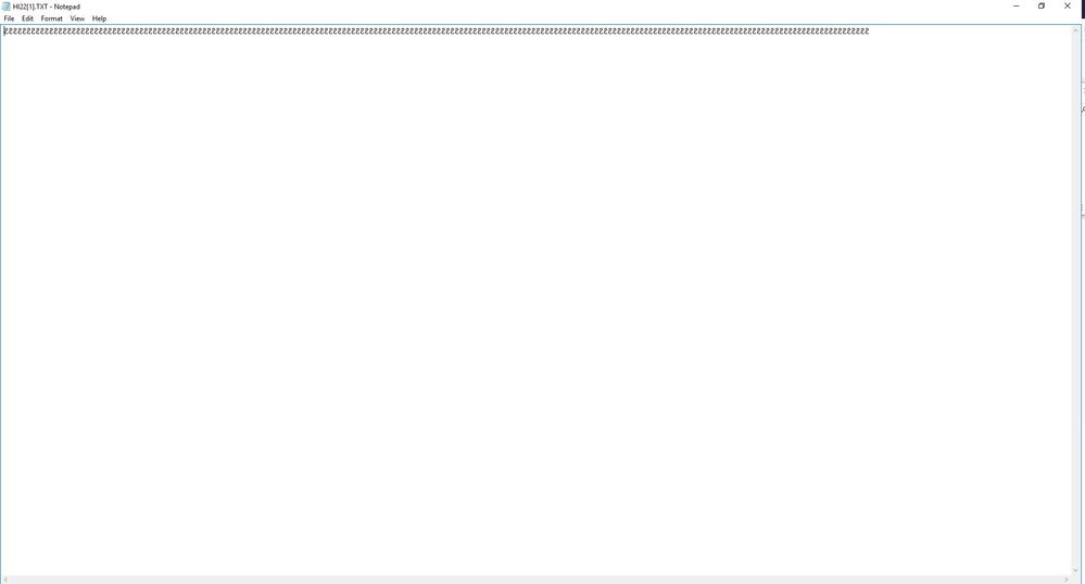

Good day everyone,
I have a slight issue, I'm storing data in the form of uint16_t data types.This data will be read in from an ADC and have values of 0 and 1. I'll have an array of 192 of these 16 bit values that I'd effectively like to store in a SDcard. The problem is that I can't directly send these to the sdcard using fwrite as it would be completely unreadable, so I'd need to convert it to a char datatype.
It seems a little counter-intuitive as char are 8 bit long and I'd need to cast 192 of these 16 bit unsigned integers.
I tried doing a cast to wchar_t and it works perfectly in the code. I can cast a uint16_t value to a wchar_t without it seeming at all computationally expensive, although when I try to send this to f_write and send it out I get complete junk.
Is there any computational inexpensive way that I can get a uint16_t array[192] into a readable format for text or binary files?
Here's a code snippet of what I've used:
uint16_t aDST_Buffer= 1100;
wchar_t Conv;
Conv =(wchar_t)aDST_Buffer;                                             //This gives me Conv = 1100
res1 = f_write(&SDFile,&Conv , sizeof(Conv ), (void *)&wbytes);        // This produces a large amount of junk.
I've seen some examples where they pass the data directly and not the address, I also tried that out of desperation without any success:
wchar_t Conv;
res1 = f_write(&SDFile,Conv , sizeof(Conv ), (void *)&wbytes);        // This produces a large amount of junk.
It doesn't seem that unicode is supported.
Thanks in advance for any help!
#fatfs #wchar_t #f_write #stm32f7

Posted on January 23, 2018 at 16:57
Review chapters on pointers and structures, basic C stuff
wchar_t Conv;
UINT wbytes; // needs to be 32-bit wide otherwise corruption will occur
res1 = f_write(&SDFile, &Conv , sizeof(Conv ), &wbytes);  // correct form, but super inefficient
uint16_t array[192];
res1 = f_write(&SDFile, &array[0] , sizeof(array), &wbytes);  // write whole array
sizeof(array) // size in bytes
array or &array[0] // base address of array in memory
You need to write a copy of the array that is NOT being updated via DMA in the background
The size of the array should be a multiple of 512 bytes, ideally much larger, otherwise the filesystem will grind and do a lot of unnecessary read/write operations
Posted on January 23, 2018 at 17:23
Hi CLive,
Thank you for the reply.
If I write an integer as in the following:
In my case:
uint16_t wtext [192] = {[0 ... 191] = 1000};
UINT wbytes;
res1 = f_write(&SDFile, &wtext[0], sizeof(wtext), &wbytes);
Then I get the following in the text file:
Full code:
UINT wbytes;
if(FATFS_LinkDriver(&SD_Driver, SDPath)==0){
res = f_mount(&SDFatFS,SDPath,1);
if(res == FR_OK){
res2 =f_open(&SDFile,''hitxt'',FA_OPEN_APPEND | FA_WRITE);
f_close(&SDFile);
Although when I write a character I can see the correct data in the text file.
Posted on January 23, 2018 at 17:32
Perhaps look at the file in a viewer that can show you the binary content.
1000 as 16-bit words would appear as
E8 03 E8 03 ...
Not printable ASCII words, not human readable. Data is represented in a machine readable form, the byte order would depend on the endian format the machine uses.
int i = 1000;
char buffer[12];
int len = sprintf(buffer, '%d ', i); // ASCII sprintf() or itoa()
res1 = f_write(&SDFile, buffer , len, &wbytes);
Posted on January 23, 2018 at 17:38
C:\CT\MSVC>dump test.out
00000000 : E8 03 E8 03 E8 03 E8 03 - E8 03 E8 03 E8 03 E8 03   ................
00000010 : E8 03 E8 03 E8 03 E8 03 - E8 03 E8 03 E8 03 E8 03   ................
00000020 : E8 03 E8 03 E8 03 E8 03 - E8 03 E8 03 E8 03 E8 03   ................
00000030 : E8 03 E8 03 E8 03 E8 03 - E8 03 E8 03 E8 03 E8 03   ................
00000040 : E8 03 E8 03 E8 03 E8 03 - E8 03 E8 03 E8 03 E8 03   ................
00000050 : E8 03 E8 03 E8 03 E8 03 - E8 03 E8 03 E8 03 E8 03   ................
00000060 : E8 03 E8 03 E8 03 E8 03 - E8 03 E8 03 E8 03 E8 03   ................
00000070 : E8 03 E8 03 E8 03 E8 03 - E8 03 E8 03 E8 03 E8 03   ................
00000080 : E8 03 E8 03 E8 03 E8 03 - E8 03 E8 03 E8 03 E8 03   ................
00000090 : E8 03 E8 03 E8 03 E8 03 - E8 03 E8 03 E8 03 E8 03   ................
000000A0 : E8 03 E8 03 E8 03 E8 03 - E8 03 E8 03 E8 03 E8 03   ................
000000B0 : E8 03 E8 03 E8 03 E8 03 - E8 03 E8 03 E8 03 E8 03   ................
000000C0 : E8 03 E8 03 E8 03 E8 03 - E8 03 E8 03 E8 03 E8 03   ................
000000D0 : E8 03 E8 03 E8 03 E8 03 - E8 03 E8 03 E8 03 E8 03   ................
000000E0 : E8 03 E8 03 E8 03 E8 03 - E8 03 E8 03 E8 03 E8 03   ................
000000F0 : E8 03 E8 03 E8 03 E8 03 - E8 03 E8 03 E8 03 E8 03   ................
00000100 : E8 03 E8 03 E8 03 E8 03 - E8 03 E8 03 E8 03 E8 03   ................
00000110 : E8 03 E8 03 E8 03 E8 03 - E8 03 E8 03 E8 03 E8 03   ................
00000120 : E8 03 E8 03 E8 03 E8 03 - E8 03 E8 03 E8 03 E8 03   ................
00000130 : E8 03 E8 03 E8 03 E8 03 - E8 03 E8 03 E8 03 E8 03   ................
00000140 : E8 03 E8 03 E8 03 E8 03 - E8 03 E8 03 E8 03 E8 03   ................
00000150 : E8 03 E8 03 E8 03 E8 03 - E8 03 E8 03 E8 03 E8 03   ................
00000160 : E8 03 E8 03 E8 03 E8 03 - E8 03 E8 03 E8 03 E8 03   ................
00000170 : E8 03 E8 03 E8 03 E8 03 - E8 03 E8 03 E8 03 E8 03   ................
Posted on January 23, 2018 at 19:07
Thank you Clive,
I completely understand now. I opened it with a binary file viewer and saw the logged data.
Thank you for always helping!
