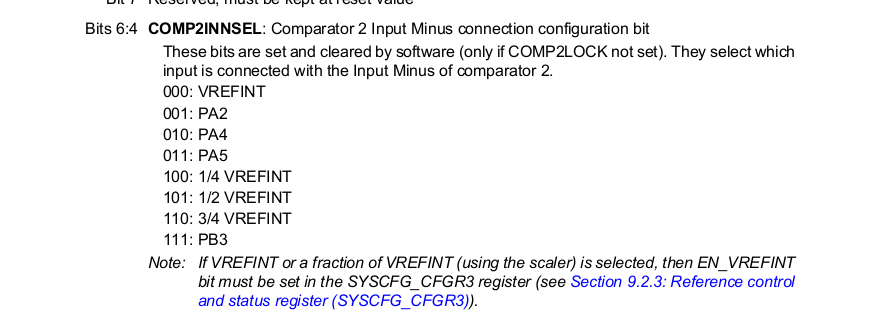

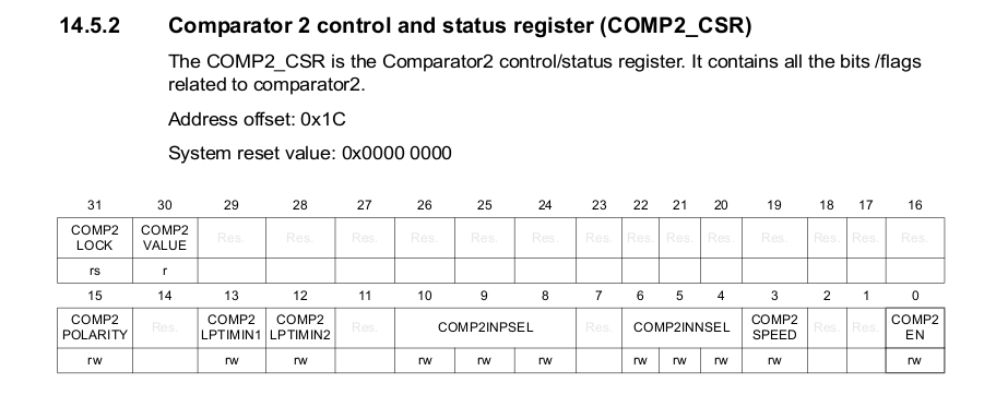

I was having some issues with getting comparator 2 working on my STM32L011K4 (Category 1 Device). I was trying tocompare a voltage on PA7 with 1/2 VREFINT. It wasn't working the way I intended it to. I dug further into the documents and found that the Low Level Drivers (FW_L0_V1.0) provided by ST is missing a bit field that is important to getting comparator 2 working with scalar VREFINT.
  • In order to get scalar VREFINT working on comparator 2, ST states the following:

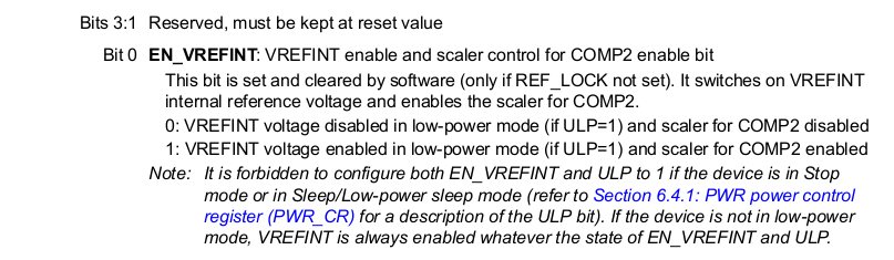

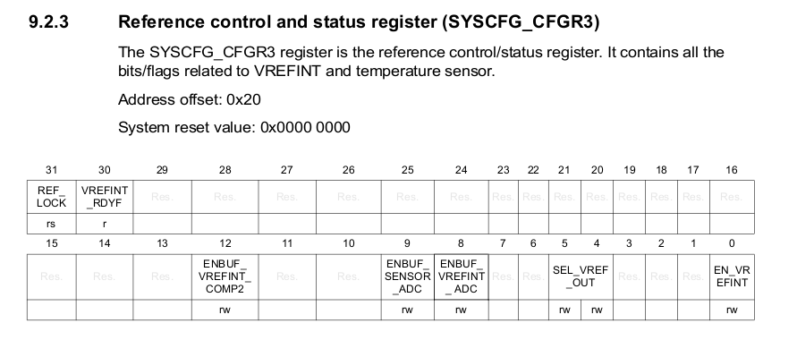

  • Moving to SYSCFG_CFGR3, it is clear in the reference manual that you have toset EN_VREFINT to get scalar voltage for COMP2:
  • Digging into the drivers stm32l011xx.h, the bit-field EN_VREFINT is missing which in turnstm32l0xx_ll_system.h doesn't have a function to set this bit high:

  • My current workaround for testing purpose is to modify a function in stm32l0xx_ll_system.h:
 * @brief Buffer used to generate VREFINT reference for comparator enable
 * @rmtoll SYSCFG_CFGR3 ENBUF_VREFINT_COMP LL_SYSCFG_VREFINT_EnableCOMP
 * @retval None
__STATIC_INLINE void LL_SYSCFG_VREFINT_EnableCOMP(void)
 SET_BIT(SYSCFG->CFGR3, SYSCFG_CFGR3_ENBUFLP_VREFINT_COMP);
 SET_BIT(SYSCFG->CFGR3, 0x1); // Setting EN_VREFINT to '1'
This workaround seems to have worked for me. I hope this is the issue and if so, gets fixed on the next version of the firmware.
