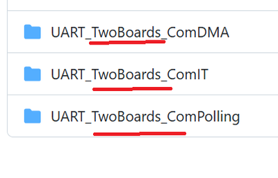

You can refer to any of the example provided in CubeH7:
https://github.com/STMicroelectronics/STM32CubeH7/tree/master/Projects/NUCLEO-H7A3ZI-Q/Examples/UART
All the examples are using two board connected over UART to transmit messages:

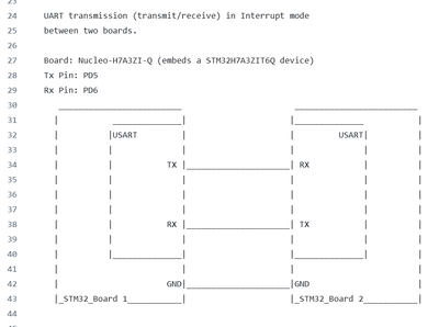

Just to make sure, you confirm that connecting the grounds is required? my working theory is that the rx reads only empty strings as it doesn't have a reference value to distinguish 0 bit to 1 bit, but it doesn't explain why the program gives error if the gnds are connected
It's mandatory.
Refer to the readme file of one of the examples provided above:
That's not only related to USART but to the most communication interfaces between boards except the differential communication protocols (like CAN for example).
