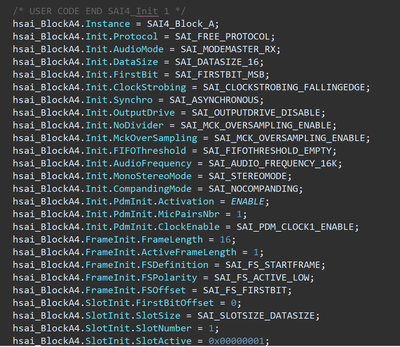

I'm slowly losing my sanity so I figure I'd make a post here. I set up SAI4 to interface with BDMA, hoping to retrieve data from the onboard MEMS microphone and store it in a buffer in RAM_D3. Ideally I'd like for that data to be processed by the CPU, but I can't even get the buffer to fill up.
The following code produces the output below:
audio_buffer[0] = 5;
audio_buffer[1] = 6;
audio_buffer[2] = 7;
audio_buffer[3] = 8;
// Inside main loop:
printf("SAI State: %d \r\n", HAL_SAI_GetState(&hsai_BlockA4));
printf("SAI Error: %lu \r\n", HAL_SAI_GetError(&hsai_BlockA4));
printf("SAI Buffer Address: 0x%08lx\r\n", SAI4_Block_A->DR);
printf("DMA State: %d \r\n", HAL_DMA_GetState(&hdma_sai4_a));
printf("DMA Error: %lu \r\n", HAL_DMA_GetError(&hdma_sai4_a));
printf("Pointer location: %p \r\n", audio_buffer);
printf("Audio Buffer Data:\r\n");
for (int i = 0; i < 10; i++) {
	printf("[%d]: %d\r\n", i, audio_buffer[i]);
As you can see, SAI4 is in HAL_SAI_STATE_BUSY_RX and BDMA is in HAL_DMA_STATE_BUSY. However, audio_buffer is not being filled. It's worth mentioning that there doesn't even seem to be zeroes coming into the buffer, as the values I set manually are never changed.
Does anyone know what may be causing this? I'll drop my CubeMX configuration, in case it is useful:
Thanks in advance :(

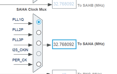

I'm not entirely sure. I am admittedly a little confused on the SAI clocks. When I wrote this reply I had the mux on CubeMX configured to send a 4.096 MHz to SAI4, since I thought that met the specs for 16kHz audio with oversampling on and no internal clock divider. Then I switched it to 50 MHz since I read that CubeMX automatically adjusts the prescalers (therefore, higher frequency = better?). Neither of them work.
The SAI needs typ. Fs x 2048 as clock; so for 44k1 stereo I2S mode audio i use 90.333MHz sai clk.
For PDM mode - i dont know, but with 16 or 32 bit /sample it should be same.
I found a way to mux ~32.768 MHz (i.e. 16,000 * 2048) to the SAI4. With master clock division and oversampling disabled, I still get all zeroes. This is 16 bits per sample. If I probe the clock pin, I see 128kHz, which doesn't feel right either.
Thank you for the reply, I'll keep chipping away at this. The clock is a new lead. I'm just so lost on how to configure it properly (it looks like a lot of registers and formulas)

I followed the first link you provided step-by-step and it's still all zeroes! I probed the CLK line and now it's 22kHz (the tutorial said to mux 2.048MHz to SAI4). I don't understand the math behind the clocking whatsoever.
miloa
I did eventually find the solution. To my original problem: I forgot to enable the active slot. It was that simple. Just go to CubeMX > SAI4 > Configuration > Active Slot and enable one or all of them.
To the zeroes problem: It was the peripheral clocks. I found this answer by JW which gave me an idea of what clock frequency I should aim for. From there I just messed around with the clock dividers until I got something very close, and now am getting a proper signal on PE2. Notably, it seems like there's something weird about the way the HAL calculates MCKDIV, so I just set the audio frequency to the one that's dependent on MCKDIV and the kernel clock and just calculated it myself with some help from the aforementioned post.
