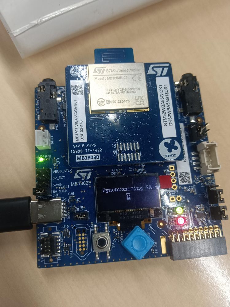

Receiver unable to properly connect/sync with transmitter BIS and play selected audio streams.

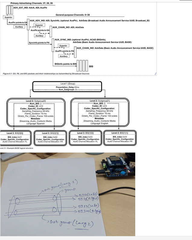

3. BIS and Subgroups
  • You mentioned Number of BIS = 4, with 2 subgroups.
    Example breakdown:
    • Subgroup 1 → BIS 0 & BIS 1
    • Subgroup 2 → BIS 2 & BIS 3
  • The transmitter (nRF5340) is advertising 4 streams grouped into 2 subgroups.
  • The receiver (STM32WBA) must parse the BASE (Broadcast Audio Stream Endpoint) info and decide:
    • Which subgroup(s) it will sync to.
    • Which BIS index(es) it will actually receive/play.qqqqqqqqqqqqqqqqqqq.png

i am implementation for oled  display to  select the audio  showing  display
Got it :white_heavy_check_mark:
I’ve gone carefully through your logs and the issue is very clear:
  • Static BIS selection works fine (you hardcode bis_indexes[0] = 0x01; bis_indexes[1] = 0x02;)
  • Dynamic BIS selection is failing: after PA sync, your code doesn’t parse the BASE → subgroup → BIS correctly, so the receiver never proceeds to BIG sync & playback.
  • You want the receiver side to:
    1. Parse the transmitter’s BASE (languages, subgroups, BIS indexes)
    2. Show them on OLED menu (eng/chi etc.)
    3. Allow joystick navigation and selection
    4. Auto-select after 2s if user doesn’t choose
    5. Pass chosen subgroup + BIS indexes dynamically to CAP_Broadcast_StartBIGSync()
    6. Establish BIG sync → Setup codec → Play audio

11 REPLIES 11
TPITEL
Hi Jeevan,
Just to clarify the situation:
  • You're using a nrf53840 Audio DK as a Broadcast Source with 2 subgroups, 2 BIS per subgroup
  • You try to synchronize to the Broadcast Source with a STM32WBA55G-DK1 with the TMAP_Peripheral app
  • The synchronization stops at "Synchronizing PA" step
Does this summarize your issue ?
If so, could you provide the full logs of the TMAP_Peripheral app when the problem occur ? Did you try to synchronize to the Broadcast Source with another nrf5340 Audio DK to ensure that the Broadcast Source is operational ?
Best Regards,
Tom.

* Step 1: Ask user which subgroup (language) to use
uint8_t chosen_subgroup = APP_SelectLanguage(TMAPAPP_Context.BSNK.base_group.NumSubgroups);
* Step 2: Extract BIS indexes from chosen subgroup
BAP_BASE_Subgroup_t *chosen = &TMAPAPP_Context.BSNK.base_subgroups[chosen_subgroup];
if (chosen->NumBISes < 2)
LOG_INFO_APP(" Error: subgroup has less than 2 BIS\r\n");
break;
uint8_t bis_indexes[2];
bis_indexes[0] = 0x03;//chosen->pBIS[0].BIS_Index;
bis_indexes[1] = 0x04;//chosen->pBIS[1].BIS_Index;

Hi Jeevan,
I understand your project but I still don't understand what's the blocking point.
According to you logs, the app successfully synchronizes to your broadcast source and should be receiving the audio. Are you sure your nrf5340 is actually broadcasting audio over the first 2 BIS ? What do you see on the OLED screen of the STM32WBA DK ?
Regards,
Tom.
Can we implement OLED display + joystick for audio selection, sync, and play?
The STM32WBA55G DK has enough resources (OLED + joystick + BLE stack) to handle dynamic BIS selection at runtime.
But your current problem is you are stuck at PA sync, so the flow never reaches the audio selection menu.
1. What you see on OLED right now
  • When the receiver DK (STM32WBA55G) is scanning and trying to sync with the transmitter (nRF5340 Audio DK),
    the OLED shows:
    Synchronizing PA... not  process  to  next step  for process
  • (A) Sync stuck at PA
    • The receiver is able to detect advertisements from the transmitter, but it gets stuck at Periodic Advertisement (PA) sync.
  • (B) UI (OLED + joystick) integration
    • You are trying to let the user choose between 2 BIS audio streams (example: English / Chinese).
    • You already updated:
      • tmap_app.c/h → to call BIS sync logic.
      • app_menu_cfg.c/h → added BIS entries (English, Chinese).
      • app_menu.c/h → joystick handling + OLED drawing.
    • But right now, the UI is not linked properly with BIS sync logic: i  write

The screen says that you are stuck at the Periodic Advertising Synchronization step but according to your logs that is incorrect. In your logs you can see  "Success: CAP_Broadcast_StartBIGSync()" which in the original source code of the app would be followed by "Menu_SetBISSyncPage" that would update the screen to the next step. Is this function actually called in your project ?
Everything in the log is fine so I would say this is probably a display issue.
Regards,
Tom.
