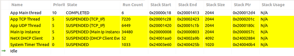

I have a question regarding Azure RTOS debugging.
I have enabled RTOS proxy and TX_ENABLE_STACK_CHECKING
but I can't see the stack usage in STM32CubeIDE. It is displayed as N/A.
How can I get this information displayed?

Oh, and look at the little icons in the upper right. One of them, looks like 3 horizontal bars, says enable stack checking. I think it's on the Azure view as well. Make sure that's checked/enabled.
‎2022-07-03 10:30 PM
Yes, check Harvery's comment. The little button with horizonal lines can be toggled on/off. The reason is that performing the "stack usage" check can take some time since we potentially have to read a lot of memory. This can impact the responsiveness when single-stepping. Rather not always have that feature impact stepping.
See the User Guide for more details on this.

Thank you @mattias norlander​ and @Harvey White​! I am able to check the stack usage now!
