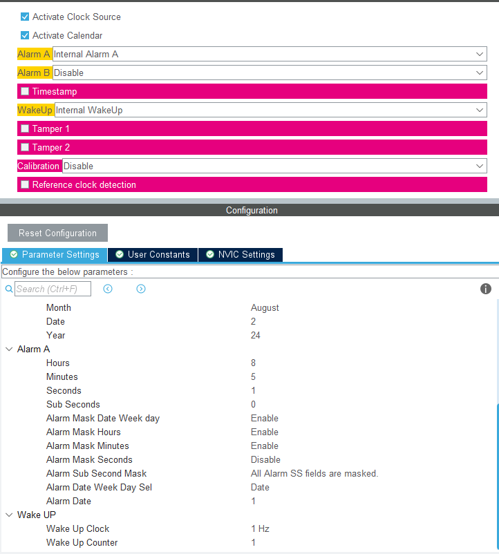

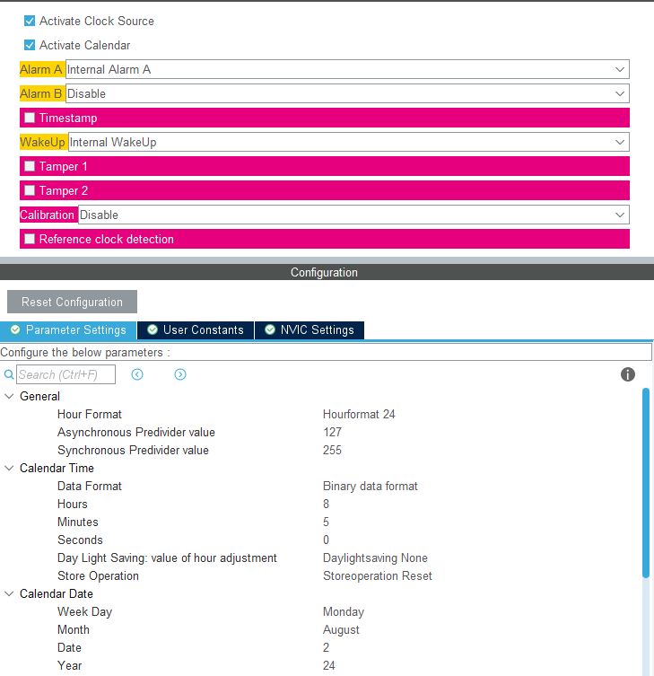

We are using the STM32U5 MCU and its internal RTC in our project.
We are facing an issue where the RTC time sometimes goes beyond 24 hours — for example, we observed a timestamp showing 37 hours.
The RTC is configured in 24-hour format, and we have initialized the RTC and its time format correctly as per the reference manual and HAL documentation.
The main challenge is that this does not happen consistently. We see such out-of-range values only randomly, which makes it difficult to identify the root cause.
Has anyone faced a similar issue with the STM32U5 RTC? Could you please suggest possible causes or solutions, or any checks we should perform to debug this behavior?
Because it's been so long, I've forgotten how I set it up back then. The problem seems to stem from the difference in settings between the `RTC_FORMAT_BIN` and `RTC_FORMAT_BCD` parameters, which led to different results. Also, the modulo operation is very important. I'm providing the code for your reference; the code might be incorrect, but it's for informational purposes only.
