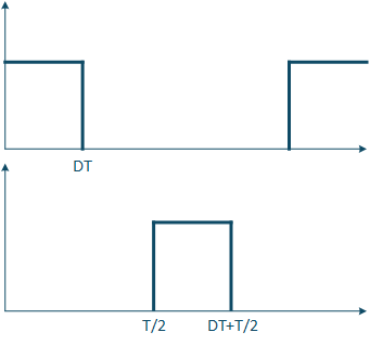

Ideally I would like the PWM outputs to look like this,
I would like the PWM frequency to be 100kHz and a duty cycle range of 0% to 50%.

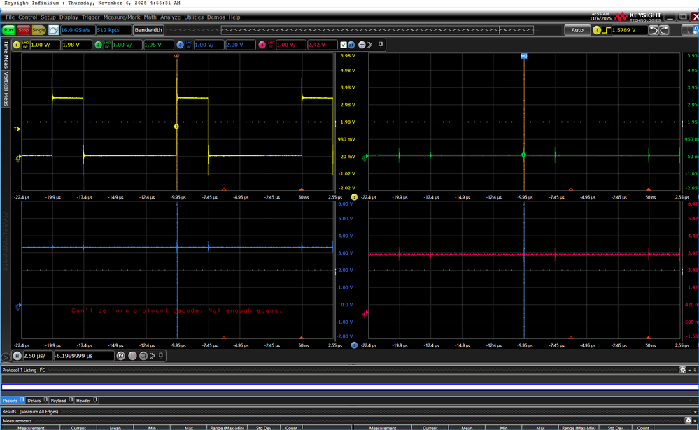

The problem I am having is with PA1. I am not getting a signal.
Channel 1 (Yellow) is PA0 and Channel 2 (Green) is PA1.
Does anyone have any suggestions on how to get PA1 working?

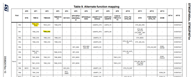

I think there is some confusion regarding the alternate function assignments for PA0 and PA1.
  • PA0 should be configured for TIM2_CH1 using Alternate Function 1 (AF1).
  • PA1 should be configured for TIM5_CH2 using Alternate Function 2 (AF2).
Your code should be like below:

	/* Configure PA0 for TIM2_CH1 */
	GPIO_InitStruct.Pin = GPIO_PIN_0;
	GPIO_InitStruct.Speed = GPIO_SPEED_FREQ_HIGH;
	GPIO_InitStruct.Alternate = GPIO_AF1_TIM2; //CH1
	HAL_GPIO_Init(GPIOA, &GPIO_InitStruct);
	/* Enable clocks */
	__HAL_RCC_TIM5_CLK_ENABLE();
	/* Configure PA1 for TIM5_CH2
	 * NOTE: Using CH2 on PA1 to avoid conflict with TIM2_CH1 on PA0
	 * You can use different pins if needed
	GPIO_InitStruct.Pin = GPIO_PIN_1;
	GPIO_InitStruct.Alternate = GPIO_AF2_TIM5; //CH2
