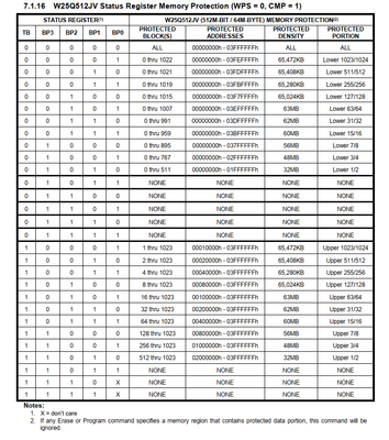

I have been trying to make a driver for the Winbond W25Q512JV, It's works normally ( I can read/write data, erase sector/chip, can write image as external flash loader with Touchgfx) until one day I could no longer erase sectors or full chips ( My chip has been erased no more than 100 times). When erasing, it doesn't report any errors, it just responds to a successful erase very quickly (~ 0.5s) , almost immediately (previously it took ~ 140 seconds to erase a full chip). When I read back these memory areas, they are not equal to 0xFF. I understand that erase has not been performed yet.

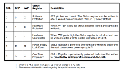

I checked by reading the registers status: reg1 = 0xFE, reg2 = 0x02, reg3 = 0x03 and compare with datasheet, it mean bit SRL = 0, SRP = 1, WEL = 1, TB = 1, BP[3-0] = 1 => My chip into protection state

Thanks for the help, as I mentioned above,  SRL = 0, SRP = 1 and I have voltage measurement on W25Q512: Vcc = 3.29V (normal), /WP = 0V, Compare with the table above, W25Q512 into hardware protected: "When /WP pin is low the Status Register locked and cannot be written to". But I used W25Q512 in QSPI mode, the pin /WP as IO2, can only be controlled by QSPI instructions software

Get the QE enabled so the pin states are for data, not write protect. Enable the pins with an internal pull-up so they aren't low or floating.
Clear the BPx and COM bits.
Mass Erase will fail immediately if any sectors are protected. It doesn't generate an "Error" as there's not way/method to report that. Watch for it taking less than a second, rather than 100's of seconds

>> Clear the BPx and COM bits => I have try to clear BPx, but when read again reg1, those bit back to 1 (CMP = 0, WPS = 0)

I tried all the solutions above, but when I read SRP, results are always returned 1, it causes nor flash to enter hardware protected mode (WP/IO2 is always in state 0 when idle in QSPI mode), I cannot erase/write any memory area, including the status register. I tried to find a way to clear this bit back to 0, but it seems that the datasheet for the W25Q512JV does not mention how to clear this bit. :frowning_face:

If you managed to set OTP bits, this cannot be undone, by design ((
Recommend to lock the status byte (or whatever it is called) early, before starting of the main app - to prevent any dangerous changes until next power cycle.
