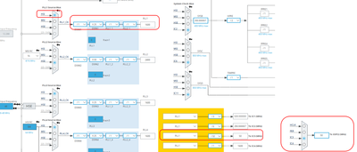

In this example, if instead of using HSI I enable HSE, I can’t get memory-mapped mode working on XSPI2.
Baord I am using is NUCLEO-N657X0-Q-C01
I replaced this function

    PeriphClkInitStruct.ICSelection[RCC_IC3].ClockDivider = 48;
In comparison original clock is setup like this:
To new one:
As it can be seen both IC3 clocks are 50 MHz.

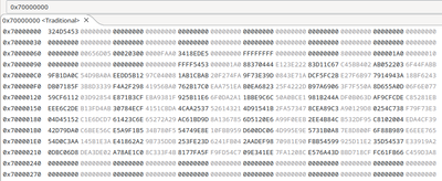

With original setup I see this on 0x7000000 address:
With HSE enabled I got this:
What could be wrong?
IgorMisic
I eventually solved it by replacing the drivers and middleware of the project  with the latest version.
Link to code: https://github.com/IMProject/IMBootloader/pull/39

i dont think, changing to HSE as clock source doing something "strange".
But to compare, all clocks+PLL setting have to be same, so adjust it and then try again.
sys not same, maybe others also:
vs
Just set the clock tree in Cube , with HSE as source; then try.
I used CubeMX just to show that the clock for IC3 is the same in both cases. I don’t use it to generate the code, as you can see from the code I pasted.
In addition, this is the code where I am trying to enable memory-mapped mode for the MX25UM51245G on XSPI2. It has HSE enabled and working.
https://github.com/IMProject/IMBootloader/blob/master/Bootloader/Adapters/Src/system_clock_adapter.c#L191-L275
Since I was unable to do it, I tested this example that has working HSI + XSPI2. Then I tried to enable HSE + XSPI2, without success.
https://github.com/stm32-hotspot/STM32N6_FSBL_Modes/blob/main/LoadAndRun/FSBL/Core/Src/main.c#L119-L198
So use Cube to make the setting with HSE , check : working ?
If ok, just look what/how its doing settings, and you know it. Then use it as you prefer.
