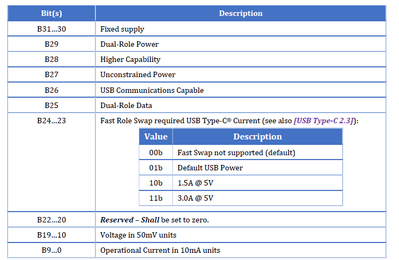

Hi @Marosh
SRC and SNK PDO are not built on same structure, so you cannot copy Received PDO from the SRC, into the SNK PDO of your equipement. Please check chapters 6.4.1.2 and 6.4.1.3 of Universal Serial Bus
Power Delivery Specification.
Example for Fixed PDO :
SRC structure :
SNK structure :
Regards
‎2024-06-05 4:39 AM
Hi @Guenael Cadiery,
Thank you very much for pointing out this issue. I have missed this difference. It seemed to me that it doesn't matter since defining the APDO in UCPD monitor yielded the same SNK APDO value as the SRC APDO when checking live expressions in the debugger.
So the step to do what I want would be extracting the type, voltage range and current from the SRC_PDO_List and using this together with the info from UM2552 (pdo def) to construct the SNK PDO. Is this correct approach?
// Example how to construct SNK APDO
/* PDO 2 : SRC APDO */
((((PWR_A_50MA(1.5)) << USBPD_PDO_SNK_APDO_MAX_CURRENT_Pos) |
(((PWR_V_100MV(3)) << USBPD_PDO_SNK_APDO_MIN_VOLTAGE_Pos) |
(((PWR_V_100MV(5.9)) << USBPD_PDO_SNK_APDO_MAX_VOLTAGE_Pos)|
USBPD_PDO_TYPE_APDO
‎2024-06-05 5:24 AM
Yes, should be better.
If I understand properly your goal, you need to adjust only the "power" related fields of your SNK PDO.
Please also note that some elements shown in the snapshots of PDO structures I attached in my previous post, are only provided in the first PDO (this concerns "global" settings or feature support, that are not PDO dependent. For instance the bit indicating support of the DRP is only provided in the first PDO, and not repeated in further ones). Just to mention this.
May I ask a question : what is the purpose of updating your SNK PDOs to received SRC PDOs ? is it related to REQUEST message building ?
(as you see, in applications ST provides, this part of code is considered as "User policy", and could be adapted as needed by your application).
Regards
