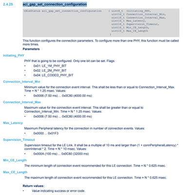

However i'm getting a strange behavior while changing the CONNECTION_INTERVAL_MS.
The maximum working value i obtained experimentally is 200 or lower.
The call where this defines is used, to configure the lower hardware level is in app.ble.c
status = aci_gap_set_connection_configuration(LE_1M_PHY_BIT,
                                                (CONNECTION_INTERVAL_MS*100)/125, (CONNECTION_INTERVAL_MS*100)/125,
                                                0u,
                                                SUPERVISION_TIMEOUT_MS/10,
                                                2, 2);
  if (status == BLE_STATUS_SUCCESS)
    APP_DBG_MSG("==>> aci_gap_set_connection_configuration Success , result: 0x%02x\n", status);
  else
    APP_DBG_MSG("==>> aci_gap_set_connection_configuration Failed , result: 0x%02x\n", status);
    Error_Handler();
As per AN6142 the maximum value configurable on this call, for "Connection_Interval_Min" and "Connection_Interval_Max" is 0x0C80  (corresponding to 4s).
Even by setting raw values on the aci_gap_set_connection_configurationnothing changes as i always get correct return values (0x00) ;however the next call which is to aci_gap_start_procedure failed with return code 0x12.
status = aci_gap_start_procedure(GAP_AUTO_CONNECTION_ESTABLISHMENT_PROC, LE_1M_PHY_BIT, 0, 0);
  if (status != BLE_STATUS_SUCCESS)
    APP_DBG_MSG("aci_gap_start_procedure - fail, result: 0x%02X\n", status);
    Error_Handler();
  else
    APP_DBG_MSG("==>> aci_gap_start_procedure (auto connection) - Success\n");

Hello @Davide Dalfra
If connection interval is changed, supervision timeout may also need to be changed. This is the description of Supervision_Timeout: The Supervision_Timeout in milliseconds shall be larger than (1 + Max_Latency) × Connection_Interval_Max × 2, where Connection_Interval_Max is given in milliseconds.
So, to be able to attend the maximum level of the Connection_Interval_Max, you need to set the Supervision_Timeout to the maximum value as indicated on the chapter 2.4.26 of the AN6182.
