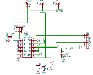

Physical Connections are as follows:
AVDD, DVDD : Connected to 5V through 10uF (tantalum) and 0.1uF (Ceramic) capacitor
OVDD : Connected to 3.3V through 1
0uF (tantalum)
COM : Connected to GND
CH0 : Input through 1000pF Ceramic capactior
SDI : SPI1_MOSI
SDO : SPI1_MISO
SCK : SPI1_SCK
CONVST & ~RD : GPIO_PIN_9
All Grounds are common.

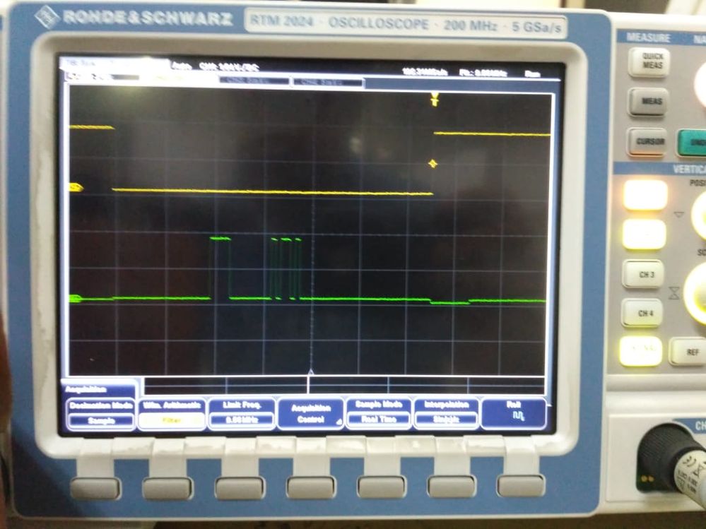

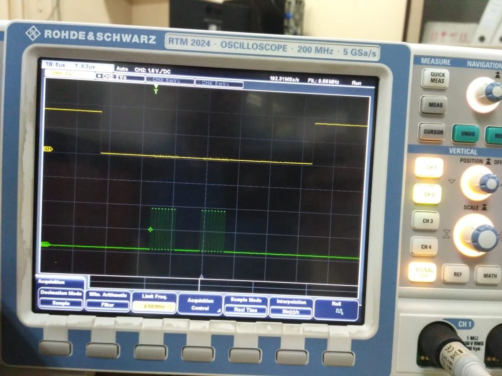

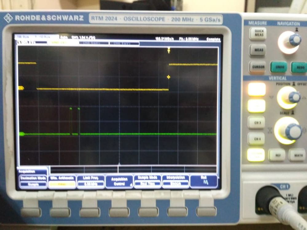

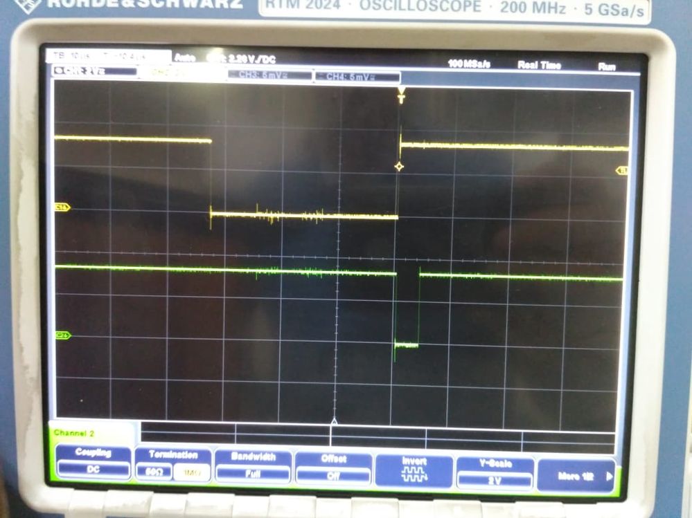

I do not have scope right now but when I put it into debug mode, I can see that the control is stuck at
while (!(hspi1.Instance->SR & SPI_FLAG_TXE));�?
and nothing is received in the Rx buffer at all. However in my original code, as you may see from the scope, Tx buffer is correctly writing 1 byte of required data, while Rx buffer is also receiving something in 2 SCLK in a communication cycle of SPI. That's how it should be. But my problem is that, the data read on Rx line is not meaningful corresponding to Input I give. Whether I give
1. 0V (GND) Rx buffer keeps fluctuating
2. or 3V, Rx buffer is still fluctuating giving an output value that in no way matches the given input.
