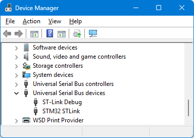

I run Windows 11 Home and, in the Device Manager, the ST link is correctly identified under Serial Bus Devices as STM32 STLink with no warning sign next to it.

@NDrag wrote:
the ST link is correctly identified under Serial Bus Devices as STM32 STLink with no warning sign next to it. t!
You mean under Universal Serial Bus devices?
That is just the SWD/JTAG/SWIM debugger part.

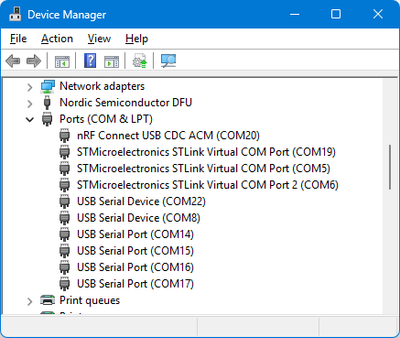

If it did have a VCP, that would appear under Ports (COM & LPT):
(I have several connected).
