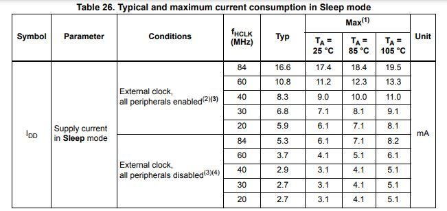

But I've read in SLEEP mode only FPU core (CPU clock) is stopped (the CPU CLK is SYSCLK / HCLK, isn't it?), peripherals keep running. When I enter in SLEEP mode, the timer will not be stopped. APB1, APB2 clocks (used for peripherals, including timers) are still running.
When the processor sleeps (between the acquisitions each 31ms) the current consumption increases proportionally to the HCLK frequency (see table below). So the current consumption at 4 MHz is lower than the consumption at 84 MHz.

But I've read in SLEEP mode only FPU core (CPU clock) is stopped (the CPU CLK is SYSCLK / HCLK, isn't it?), peripherals keep running.  .
You control whether the other clocks & peripherals continue or not.
