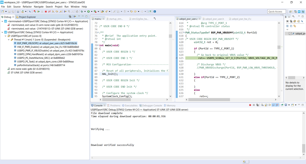

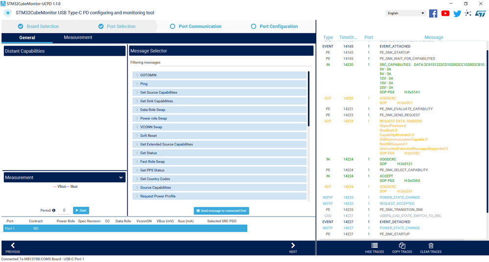

Hi Yohann,
I am able to get 15V across VBUS after I connect my Disco board to Source device, but the ADC reading value is 16125mV. I found ADC reading Error while reading High voltages(i.e. greater than 10V).
please have a look at the fallowing USBPD log:
After some period of time(typically 10S) PD is Resetting automatically. I suspect that is because of ADC Error only, please suggest some changes to us so that we can get better accuracy.
Note : after 10 seconds BSP_PWR_VBUSOff() automatically getting called.
I have couple of questions for you, please don't hesitate to answer this.
  1. what is the VBUS voltage without cable connection(or before cable connection)?
  2. I am connected Vref+ to VDDA. if I use Vref+ externally, is that going to be reduce my ADC Error?
Thanks & Regards
-himavanth
1- what is the VBUS voltage without cable connection(or before cable connection)?
VBUS should be at 0V of course... SRC path should be disabled.
2- I am connected Vref+ to VDDA. if I use Vref+ externally, is that going to be reduce my ADC Error?
Internal VREF should be enough for the VBUS measurement. Voltage divider is it correct? What the resistors you put on your board (RA/RB)?
For your test, you can keep the SRC PDO set to 5V and check that you are able to measure correctly 5V on your ADC channel.
In the attached screenshot you put, I don't have a success of the negociation. SRC did not sent a PS_RDY, there is a detach before.
Question: did you change the content of the function 'USBPD_PWR_IF_SetProfile'. Do you set correctly the VBUS value? The code I have is the default the 1st PDO set to 5V.
Note: instead of doing a copy of our cubeMX, you can deliver a file automatically saved on your laptop (.cpd file) under c:\Users\your_login\AppData\Local\Temp\STM32CubeMonitor-UCPD\Acquisition\. (https://wiki.st.com/stm32mcu/wiki/USB_Power_Delivery_overview#Specific_tools)
HGorl.1
After changes to RA (RA 36000)and RB (RB 6040)values I can able read the some what accurate value. i.e. 15V VBUS as 14908mV. seems to be allowable.
Even after this setting USBPD control getting to BSP_PWR_VBUSOff() each time after Power profile setting.
I didn't made any changes to USBPD_PWR_IF_SetProfile.
still the SRC did not sent a PS_RDY, there is a detach before.
Thank you

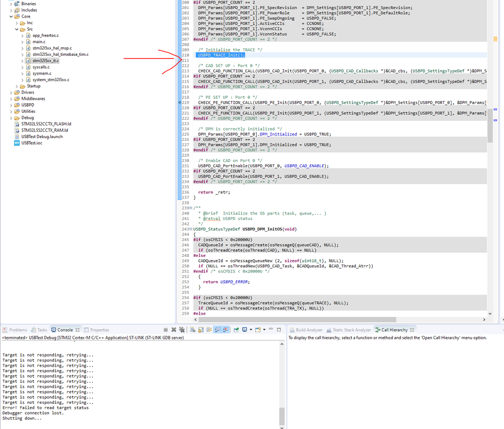

im trying hard to run the USB PD feature on the STM32L552CCT6 controller.
So i rebuild the USB-PD_Consumer_1port example for the STM32L5 to my controller.
All is the same, but when im trying to start and debug the program, the controller stucks after the initalization.
I figured out that the last called function is the  USBPD_TRACE_Init(); in the usbpd_dpm_core.c file.
After that the debugger lost the connection to the target and the program stucks. I have to erase the full chip to get the connection again.
I have really no idea whats going on.
So my question is: Does anybody have an idea where the problem is?
Thanks!
Hello
Could you please create a new thread for your question?
Thanks
