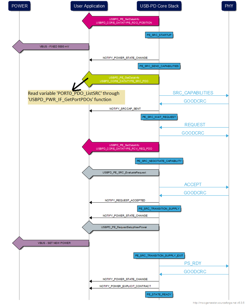

Power negociation follows the AMS described in UM2552 in 'Figure 24. SRC power negotiation':
You should update your function ''
  * @brief  Allow PDO data reading from PWR_IF storage.
  * @param  PortNum Port number
  * @param  DataId Type of data to be read from PWR_IF
  *         This parameter can be one of the following values:
  *           @arg @ref USBPD_CORE_DATATYPE_SRC_PDO Source PDO reading requested
  *           @arg @ref USBPD_CORE_DATATYPE_SNK_PDO Sink PDO reading requested
  * @param  Ptr Pointer on address where PDO values should be written (u8 pointer)
  * @param  Size Pointer on nb of u32 written by PWR_IF (nb of PDOs)
  * @retval None
void USBPD_PWR_IF_GetPortPDOs(uint8_t PortNum, USBPD_CORE_DataInfoType_TypeDef DataId, uint8_t *Ptr, uint32_t *Size)
    if (DataId == USBPD_CORE_DATATYPE_SRC_PDO)
      *Size = PORT0_NB_SOURCEPDO;
      memcpy(Ptr,PORT0_PDO_ListSRC, sizeof(uint32_t) * PORT0_NB_SOURCEPDO);
/* USER CODE BEGIN USBPD_PWR_IF_GetPortPDOs */
  *Size = 0;
  switch(DataId)
  case USBPD_CORE_DATATYPE_SRC_PDO :
    break;
  default :
    break;
/* USER CODE END USBPD_PWR_IF_GetPortPDOs */

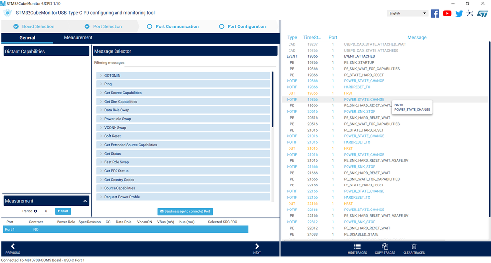

Please have a look at the picture attached below. This when Discovery kit from ST attached to custom board after programming. (Note : we are working to Develop code from USB-PD_Provider_1port & code changes suggested in previous disscussion have been made, even though thing not working properly)
Please have a look at the files by going through the link:
https://drive.google.com/drive/folders/1enntGvObHZ_xGk3DRsqFqliGJxErmrvz?usp=sharing
  1. please suggest any other changes to files mentioned in the link.
  2. Do USB-PD_Provider_1port example from ST community works by default(with out code changes)?
  3. State of Policy Engine is held at reset(from the figure attached above), if so suggest necessary changes to Header files and C files mentioned in the link to work PD in Source mode PD3.0 PPS version.
Thanks & Regards
-Himavanth

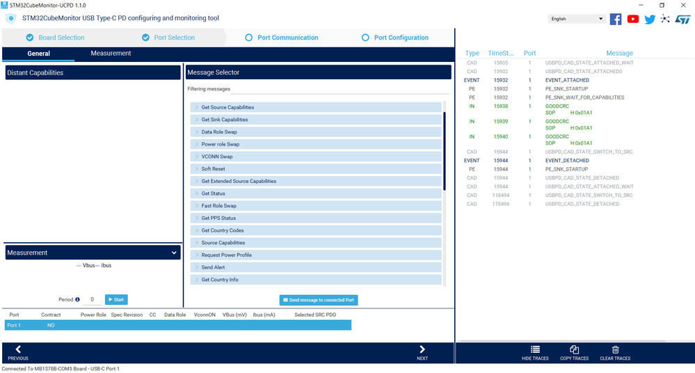

  3. Screenshot you attached cannot be done with USB-PD_Provider_1port application because, I can see the GUI interface has been enabled and stack is entered in Sink state and wait for a SRC capability from port partner. To enable, you just need to add a APDO in your usbpd_pdo_def. h file like:
#define PORT0_NB_SOURCEAPDO        1   /* Number of Source APDOs (applicable for port 0)  */

Explanation to 3rd reply:
you are right ! we are using Discovery kit as sink and our custom(proprietary board from the organization) board as source, and the image I attached is form sink configuration side one only.
with the image attached above I found Source is not communicating Properly because of Source PE held at reset set. if my assumption is correct please conform it.
Thanks & Regards

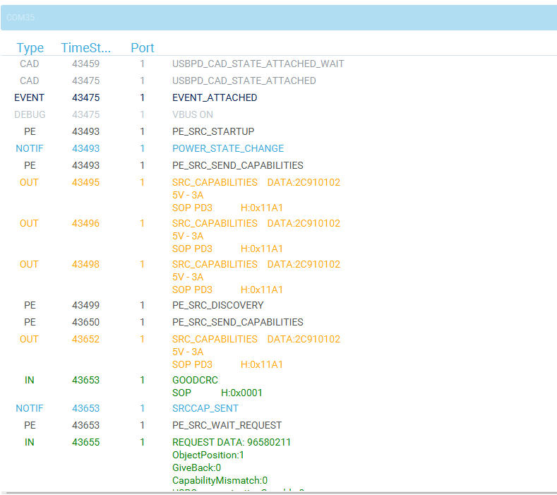

Hi @HGorl.1​ ,
DemoUCPD is the complete application which supports main feature on our stack (dual port with DRP on 1 port and sink on the other one, GUI, PPS...) Idea with simple provider application generated with CubeMx was to provide a very simple SRC application to allow to negotiate a contract to 5V/3A.
I have no more suggestions to provide to you. It should work as it is. Idea is to add your own code linked to your needs (adding PDO ?) in the basic application (in taking demonstration as code example).
The image I attached is a EVAL board using the Provider application connected to the G0-DISCO board. There are no issues, just few SRC capability messages re transmission and finally request message sent by the disco.
Regards,
Yohann

HGorl.1
Hi Yohann,
Thank you for the reply.
I made few code changes suggested by you. Sorry I can't provide TRACER_EMB facility as we are using SWD debugger instead of JTAG debuggers.
I found JTAG debug facility is necessary for USBPD debug trace so I can't provide you the source side trace.
please have a look at the responds when I connected STM32G071B-DISCO in stand alone mode.
Note: Trace is from Sink device( STM32G071B-DISCO )attached to our Custom board.
Even after the code changes I couldn't find the source capabilities but I am getting the GoodCRC. I have gone through the wiki link provided by you I found few information relating to previous suggestion made by you.
Please Do have patience to have a look at debugging observation after cable connection:
  1. I found control is coming to both USBPD_CAD_Task & USBPD_PE_Task now after cable detection.
