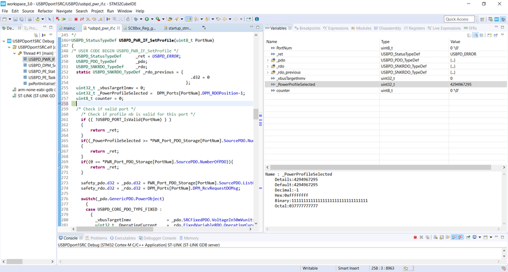

HGorl.1
Hi Yohann,
please have a look at the fallowing.
if((_PowerProfileSelected >= *PWR_Port_PDO_Storage[PortNum].SourcePDO.NumberOfPDO))
    	return _ret;
if((0 == *PWR_Port_PDO_Storage[PortNum].SourcePDO.NumberOfPDO)){
    	return _ret;
after a lot of time spending in Debugging device I found _PowerProfileSelected initialized with DPM_Ports[PortNum].DPM_RDOPosition is always 0(which shouldn't be).
I feel DPM_Ports[PortNum].DPM_RDOPosition should be updated after each negotiation... please suggest me some code changes so that RDO position update each time after negotiation.
Thanks for your support in building and Initializing PDO's.
Thanks & regards
-Himavanth
Hello
You are right, as written in the demonstration, you should save the RDO position in the 'USBPD_DPM_EvaluateRequest' function like this:
USBPD_StatusTypeDef USBPD_DPM_EvaluateRequest(uint8_t PortNum, USBPD_CORE_PDO_Type_TypeDef *PtrPowerObject)
/* USER CODE BEGIN USBPD_DPM_EvaluateRequest */
  USBPD_StatusTypeDef _retr = USBPD_REJECT;
  USBPD_PDO_TypeDef pdo;
  USBPD_SNKRDO_TypeDef rdo;
  /* read the request value received */
  rdo.d32 = DPM_Ports[PortNum].DPM_RcvRequestDOMsg;
  /* Search PDO in Port Source PDO list, that corresponds to Position provided in Request RDO */
  if (USBPD_PWR_IF_SearchRequestedPDO(PortNum,  rdo.GenericRDO.ObjectPosition, &pdo.d32) == USBPD_OK)
    /* Evaluate the request */
    if(pdo.GenericPDO.PowerObject == USBPD_CORE_PDO_TYPE_FIXED)
      if((rdo.FixedVariableRDO.OperatingCurrentIn10mAunits > pdo.SRCFixedPDO.MaxCurrentIn10mAunits)
         || (rdo.FixedVariableRDO.MaxOperatingCurrent10mAunits > pdo.SRCFixedPDO.MaxCurrentIn10mAunits))
        /* Sink requests too much maximum operating current */
        /* USBPD_DPM_EvaluateRequest: Sink requests too much maximum operating current */
      else
        /* Save the power object */
        *PtrPowerObject = pdo.GenericPDO.PowerObject;
        /* Set RDO position in DPM port structure */
        DPM_Ports[PortNum].DPM_RDOPosition = rdo.GenericRDO.ObjectPosition;
         _retr = USBPD_ACCEPT;
  return _retr;
/* USER CODE END USBPD_DPM_EvaluateRequest */

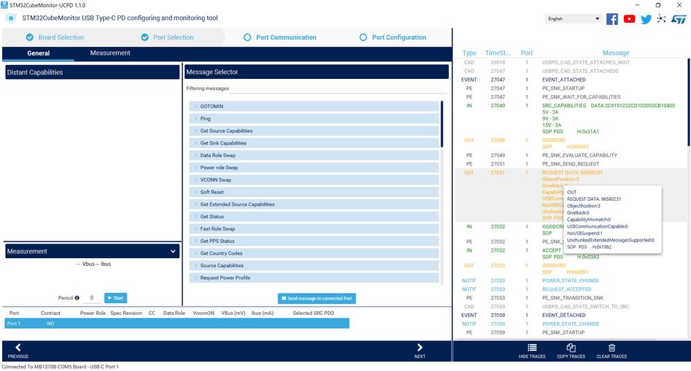

HGorl.1
Thank you Yohann!. that solves my issue with finding an appropriate position of PDO after negotiation.
After negotiation I found system Hard Resetting every time and finally I found Route cause is from the function attached below.
I found Status variable is USBPD_HR_STATUS_START_REQ which cause to Hard Reset. please tell us reasons to get system Hard Reset.
  * @brief  Callback function called by PE layer when HardReset message received from PRL
  * @param  PortNum The current port number
  * @param  CurrentRole the current role
  * @param  Status status on hard reset event
  * @retval None
void USBPD_DPM_HardReset(uint8_t PortNum, USBPD_PortPowerRole_TypeDef CurrentRole, USBPD_HR_Status_TypeDef Status)
/* USER CODE BEGIN USBPD_DPM_HardReset */
  switch (Status)
  case USBPD_HR_STATUS_START_ACK:
  case USBPD_HR_STATUS_START_REQ:
      /* Reset the power supply */
      USBPD_PWR_IF_VBUSDisable(PortNum);
      break;
  case USBPD_HR_STATUS_COMPLETED:
      USBPD_PWR_IF_VBUSEnable(PortNum);
     break;
  default:
    break;
/* USER CODE END USBPD_DPM_HardReset */
Note: I couldn't find Hard Reset message from attached device.

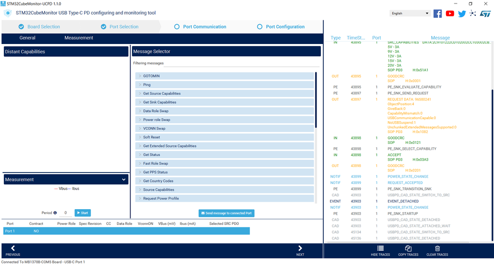

Could you please provide a PD log? With DISCO?

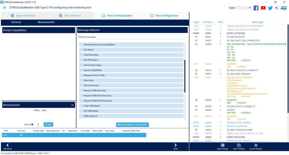

HGorl.1
Here is my PD log after I connect Disco board.0693W000003QxfWQAS.png0693W000003QxchQAC.png
PDO4 is requested (15V) but after transition to this voltage, we should received a PS_RDY message but a detach is detected by the device.
Could you confirm that you are able to switch correctly to 15V?
HGorl.1
Yeah. I am able to get 15V properly. No issue at all.
As I am using different Feed back values(RA and RB values) in currently using board....I suspect I used RA and RB values comes with BSP board...if This is an issue with please confirm with Yes.
You can put a breakpoint in BSP_USBPD_PWR_VBUSGetVoltage and check the value of VBUS returned by this function.
