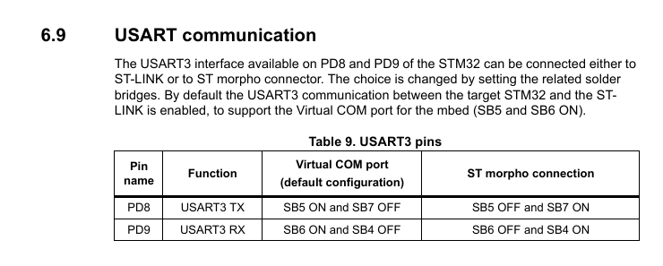

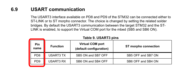

The VCP is connected to pins PD8 (UART TX output) and PD9 (UART RX input):
You won't get anything through the VCP unless you use those pins!

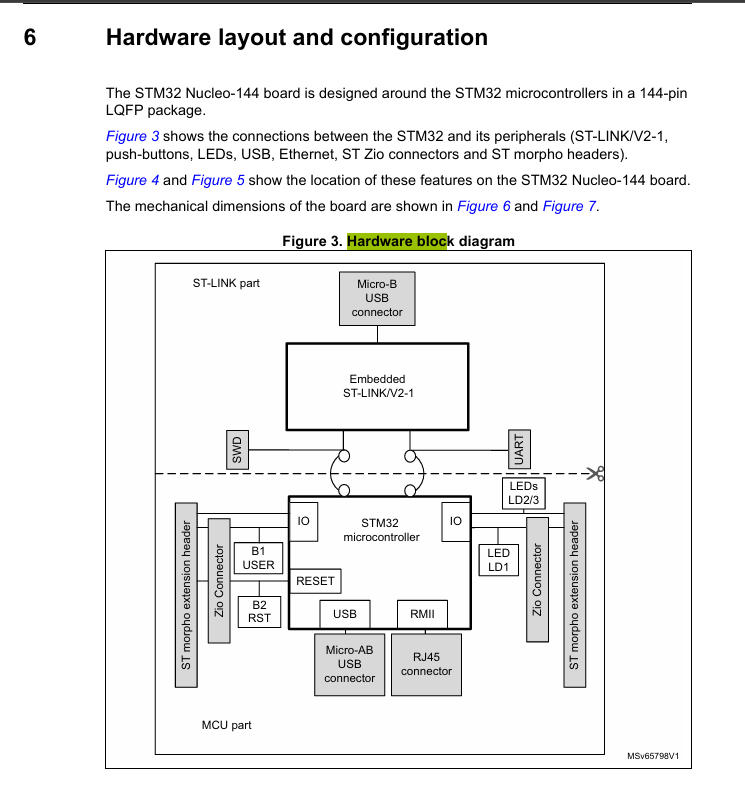

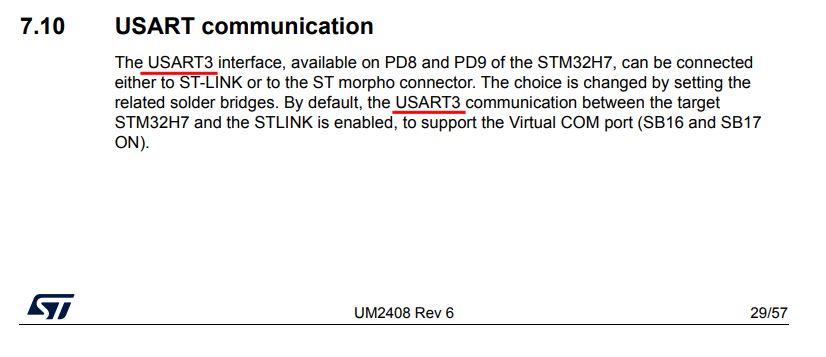

@KRISH_  If you're expecting to use the Virtual COM Port (VCP) in the ST-Link, that is connected to USART3 - not USART2:
https://www.st.com/resource/en/user_manual/um2408-stm32h7-nucleo144-boards-mb1363-stmicroelectronics.pdf#page=29
via: https://www.st.com/en/evaluation-tools/nucleo-h7a3zi-q.html#documentation

I checked the User manual, it said USART3 .But still I wasn't able to enter anything in the serial console.1.png2.png

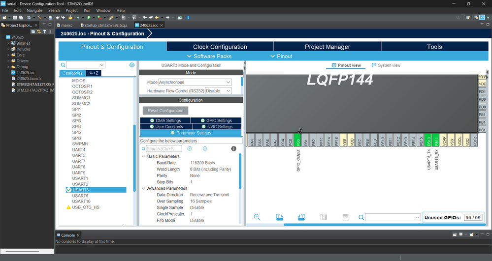

The pins shown in the user manual are PD8 and PD9, but by default, the assigned pins are PB10 and PB11.In the NVIC settings I have enabled USART3 as global interrupt.
Those are the pins connected to the VCP - so those are the pins you must use.

  /* USER CODE END 1 */
 while (1)
	HAL_UART_Transmit(&huart3, (const uint8_t)msg, strlen(msg), TIMEOUT);
The putty is blank
