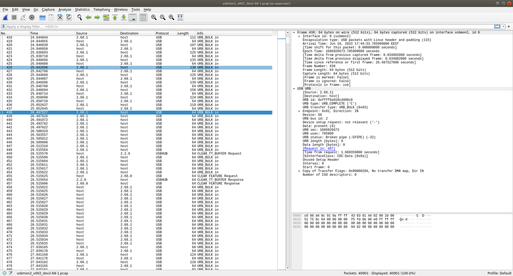

Hello!
HW: NUCLEO-H743ZI
SW: MxCube v6.8.1
Application: USB CDC
OS: Ubuntu 20.04.1  5.15.0-75
USB Hub: No, the device is connected directly to the USB port (without any USB hubs usage)
It was generated a USB CDC Application solution by using MxCube v6.8.1
Some Log Data is transferred to the PC by using USB CDC to PC continuously
By using Wireshark, I see that messages with "data" is transferring each 2-3ms, but sometimes, the USB-Device answers with "BROKEN_PIPE" status message(see image bellow)
Could you help to define which reason was to generate BROKEN_PIPE message?
Which interrupt bit could be set by MCU embed USB device to inform the application about such type of message?
A similar problem was described in:
