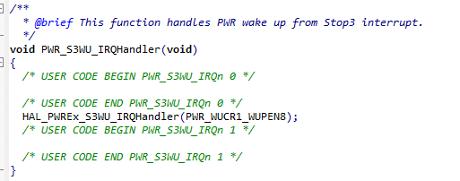

As mentioned by @Imen.D, please redefine the PWR_S3WU_IRQHandler to wake up the system as shown below.
This scenario was tested with IAR, STM32Cube programmer v1.17.0 and STM32Cube programmer v1.18.0.
Please try to use the newer versions as they are more up-to-date and can help avoid any potential issues.

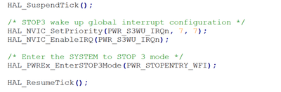

Please ensure that you suspend the SysTick interrupt before entering STOP mode as shown below:
With Regards,
‎2024-12-27 8:43 AM
SysTick is suspended and binary is generated from PWR_LPMODE_RTC example only, so it is already taken care in that example.
Thanks,
Mohan
