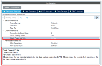

2.  In MX, ST SPI CPOL and CPHA (1_EDGE, 2_EDGE), how it corresponds to different terminology used by some sensor datasheet, mode 1 to mode 4, or mode "00", "11"

Hi @Dor_RH ,
> Understand the CPOL and CPHA values to configure the correct SPI mode.
I believe @David_  does understand what CPOL and CPHA do. I believe he refers to the fact, that in CubeMX/Cube ST uses a non-standard terminology (1_EDGE, 2_EDGE) to describe the CPHA settings, with no explanation what's their relationship.
Yes, this can be found out by studying the Cube sources (macros which define 1_EDGE and 2_EDGE, I'm not going to look them up now), but once ST made the wrong decision to depart from the industry standard, this should be remedied by an explicit explanation in CubeMX at least.

In MX, you can find a parameter description regarding clock phase (CPHA) that may help you.

waclawek.jan
Thanks, this explains it.
A little bit clumsy, but at least the values are there.
Many many years ago, when I first came across SPI, that material put it in this way: CPHA=0 -- sample, then shift; CPHA=1 -- shift, then sample. I find this to be a concise description up to this day. This of course was in the times when familiarity with hardware (here shift registers, as SPI is nothing but) was a given amongst mcu programmers.
