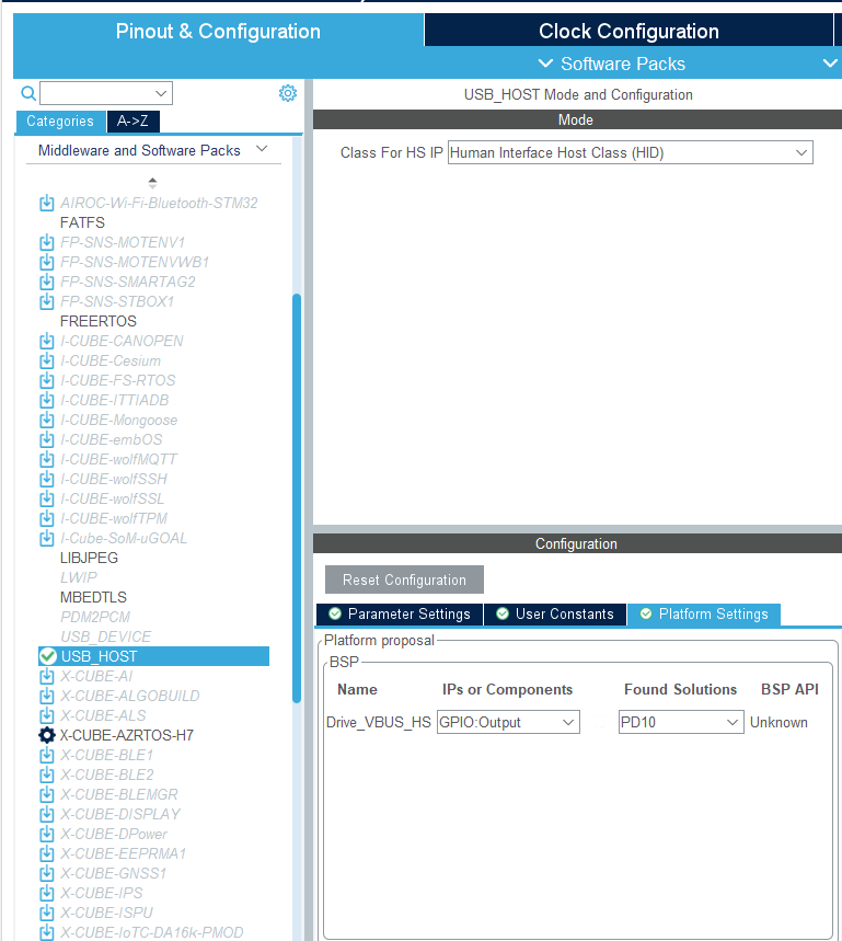

In the connectivity category, click on USB_OTG_HS and choose:
  • Host only under internal FS PHY.
  • Activate VBUS under “Activate VBUS".
  • Select "USB on the Go HS global interrupt" checkbox in NVIC settings.
  • In “Middleware and Software Packs”, choose USB_Host then select HID as a class.

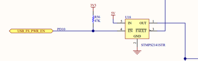

  • In the “Platform Settings”, select “GPIO:Output” as Drive_VBUS_HS and choose your specific board VBUS supply pin after configuring it as GPIO output in the pinout view.
To know your USB_FS_PWR_EN pin, check your board schematic. In our case, for example, we need to refer to the MB1364 schematic:

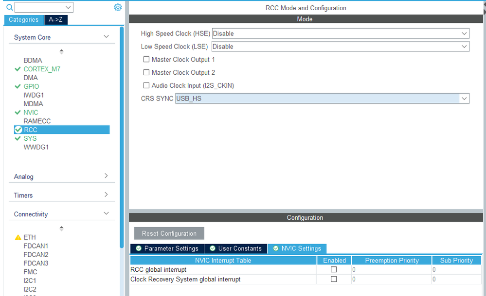

  • In the system Core category and for RCC, select USB_HS for CRS SYNC.

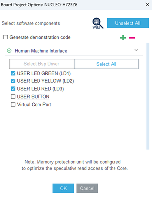

  • In the board project options that pops up, select only the USER LEDs, and press [OK].

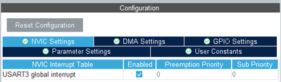

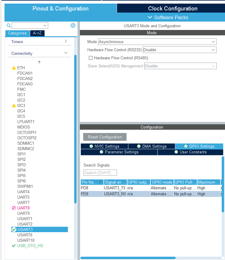

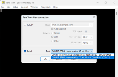

  • In the “Connectivity” category, click your board specific USART linked to your ST-LINK via the Virtual Com Port. Check the board schematic to identify the USART to activate. In our case, it is USART3.
  • Choose asynchronous mode.
  • Make sure that STM32CubeMX has configures the exact pins that are used on your board schematic.
  • Ensure that you select a High speed for the GPIOs and enable your USART global interrupt in NVIC settings.

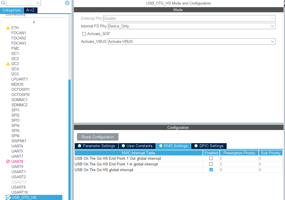

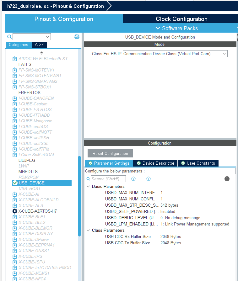

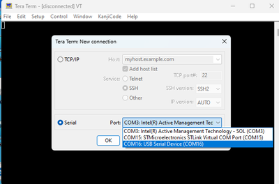

  • In USB_OTG_HS select “Device only” and activate VBUS as well as USB OTG global interrupt in NVIC settings.
  • In “Middleware and Software Packs”, click on "USB_Device" and choose “Communication Device Class”.

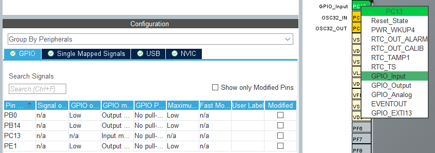

  • Configure the board-specific pin connected to the blue button as a GPIO input (PC13 in our case):

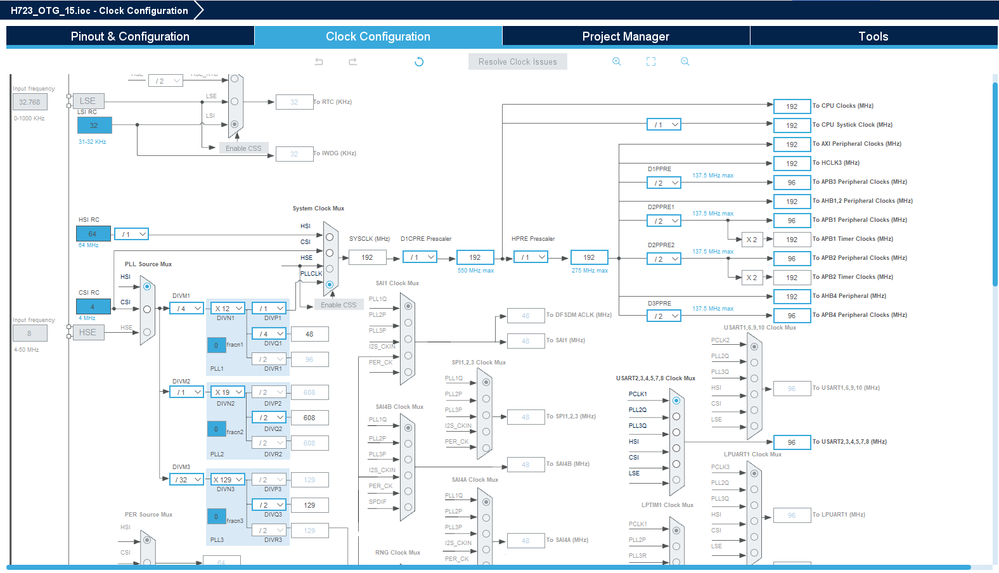

  • In clock configuration, ensure that you are using the HSI clock source from the PLL source.

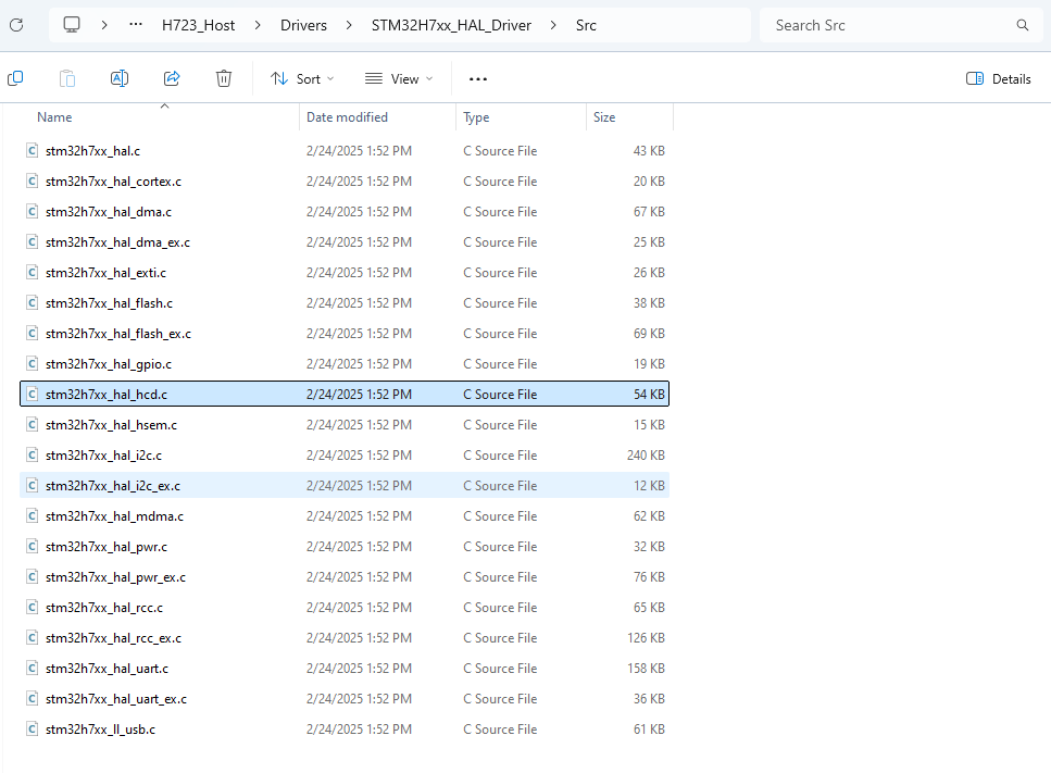

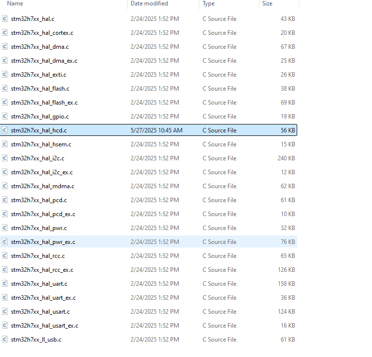

  • In the host project, go to "Drivers/STM32H7xx_HAL_Drivers/Src”.
  •  Copy the stm32h7xx_hal_hcd.c file to the corresponding location under “Drivers/STM32H7xx_HAL_Drivers/Src” in the dual role project:

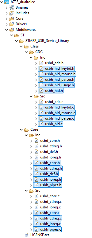

  • The table below lists all the required middleware files to add :
Source path Destination path Files
h723_Host\Drivers\STM32H7xx_HAL_Driver
\Inc
h723_dualrole\Drivers
\STM32H7xx_HAL_Driver\Inc
stm32h7xx_hal_hcd.h
h723_Host\Middlewares\ST
\STM32_USB_Host_Library\Class\HID\Inc
h723_dualrole\Middlewares\ST
\STM32_USB_Device_Library\Class
\CDC\Inc
usbh_hid_keybd.h, usbh_hid_mouse.h, usbh_hid_parser.h, usbh_hid_usage.h
\STM32_USB_Host_Library\Class\HID\Src
\CDC\Src
usbh_hid.c, usbh_hid_keybd.c, usbh_hid_mouse.c, usbh_hid_parser.c
\STM32_USB_Host_Library\Core\Inc
\STM32_USB_Device_Library\Core\Inc
usbh_core.h, usbh_ctlreq.h, usbh_def.h, usbh_pipes.h
\STM32_USB_Host_Library\Core\Src
h723_dualrole\Middlewares\ST\
STM32_USB_Device_Library\Core\Src
usbh_core.c, usbh_ctlreq.c, usbh_ioreq.c, usbh_pipes.c
  • Then click refresh.
Your project structure should be as shown below:

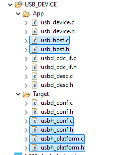

  • The table below lists the source files to add :
h723_Host\USB_HOST\App h723_dualrole\USB_DEVICE\App usb_host.c, usb_host.h
h723_Host\USB_HOST\Target h723_dualrole\USB_DEVICE\Target
usbh_conf.c
usbh_conf.h
usbh_platform.c, usbh_platform.h
The structure should be organized as illustrated below:

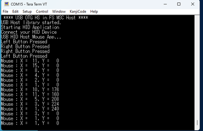

  • Open usb_host.c under USB_HOST/App and replace the existing code with the code provided below:
This code implements mouse and keyboard host functionalities.

  • In usbh_conf.c, add this line:
#include "stm32h7xx_hal_hcd.h"
  • In "stm32h7xx_hal_conf.h" look for HAL_HCD_MODULE_ENABLED and uncomment it:
 #define HAL_HCD_MODULE_ENABLED

  • Attach a mouse to the board through the Type A micro-B adapter and open your serial monitor toolchain.
  • Choose the ST-LINK port.
You should see mouse traffic in the serial monitor.
  • Remove the mouse and attach the board to the pc from the USB connector through a “Type A to micro-B” cable. Press the blue button. Integrated LEDs turns on to validate the switch.
The device mode is programmed as CDC class that prints hello world repeatedly on the serial monitor.
