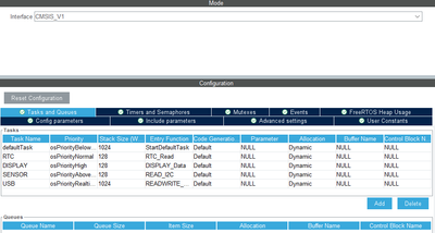

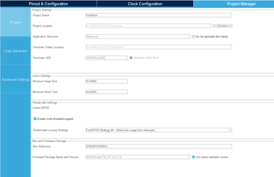

‎2024-07-05 10:22 PM
Hello @nouirakh
I increased the stack size and heap size as you can see. and also change the default task that MX_USB_HOST_Init(); is in there. but nothing happened.
Is this the place to increase stack size that you mentioned?

‎2024-07-08 1:46 AM
Hello @AMIR-F-O
You can change the stack sizes using STM32CubeMX by following these steps:
- Go to the "Middleware" section in the left-hand pane.
- Click on "FreeRTOS" to open the FreeRTOS configuration settings.
- In the FreeRTOS configuration window, you will see a list of tasks.
- For each task, you can set the stack size. Click on the task you want to modify. In the properties pane, find the "Stack Size" field. Enter the desired stack size for the task.

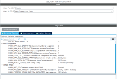

I Increased the stack size as you mentioned but randomly have trouble again.
beside that I change task priority and likewise I wrote random stuck in initializing. but somehow after 5 or more reset it pass to run program. after that I can't read or write USB like when I use USB_MSC in superloop mode. (I mean "usb_host.c" file)
I have some question for be sure that I have no bug on Cube IDE.

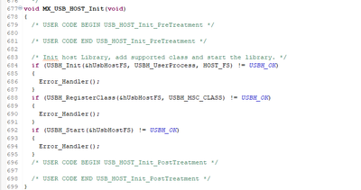

1. is there any visible task when generating code for USB_USE_OS?
2. Do I need function to run USB in tasks?
3.this is code generated Initializing USB is it ok?
and more to ask :)
‎2024-07-08 3:03 AM
Hello @AMIR-F-O
Visible task when generating code for USB_USE_OS?
When you enable USB Host with FreeRTOS in STM32CubeMX, it should generate tasks that handle USB operations. These tasks are typically created in the usb_host.c file. You should see a task dedicated to USB processing, often named something like USBHProcess.
Running USB in Tasks?
Yes, you need to ensure that the USB Host processing is running within a FreeRTOS task. This is usually handled by the generated code, but you need to make sure that the task is properly created and scheduled.

‎2024-07-08 3:32 AM
Thankyou @nouirakh
the Code Below show all script of my "usb_host.c" that code generator made it.
So this is the problem. code generator has bug for me. I am using CUBE IDE 1.15.1. what should I do for this issue? or should I add some code manually into it!
