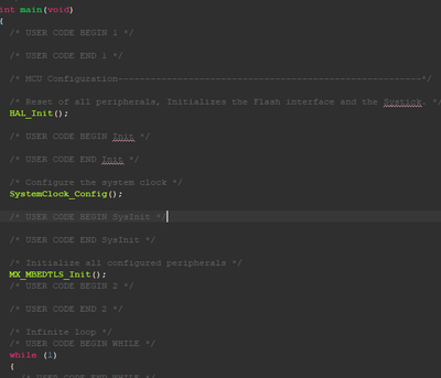

Why is MX_MBEDTLS_Init called twice at startup when using stm32CubeMx code generation?

@STeaI've reinstalled STM32CubeIDE and started a new branch so that I could reconfigure mbedtls from scratch.
MX_MBEDTLS_Init is still called twice. You can find my project in the 7z attachment.
I'm also a bit confused as to why the function is called before FreeRTOS is running.
mbedtls_net_init calls MX_LWIP_Init and this should be called at the start of mbedtls configuration from what I see in examples : https://github.com/Mbed-TLS/mbedtls/blob/development/programs/ssl/ssl_client1.c
However MX_LWIP_Init also creates two threads so it cannot be called before FreeRTOS runs.
