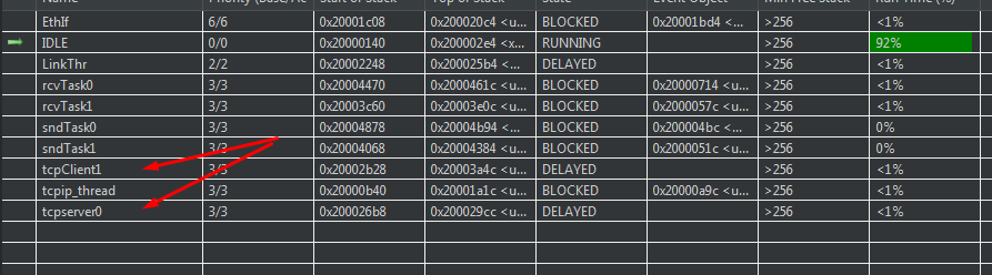

Ivan Pletnev
0693W000008w2BYQAY.pngThis is a my tcp client. It is works fine together with tcp server on the same mcu.
void tcp_client_socket_thread(void *arg) {
