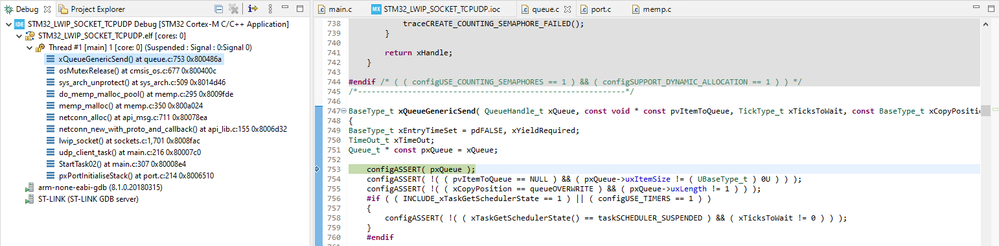

I am trying to implement TCP and UDP server connection on my STM32F407-Discovery Board. I use Socket API with FreeRTOS.
I am able to run TCP or UDP seperately. Single server or client works fine.
When I combine TCP and UDP server tasks at the same code. None of them work. I can not even PING my STM32 board. I created different two tasks for each TCP and UDP server.
I tried to increase HEAP size of LWIP above 32KB. However, it did not resolved my issue.
Are the any solution to my issue ?
Thank you in advance for your help. Best Regards

I have two tasks. StartDefaultTask and StartTask02
StartTask02 task called first and ıt stacks in line as shown in the picture below.
StartDefaultTask never called by OS.
I think there is a memory allocation problem
Piranha
Chief II
@voyvoda .​​, the main problem is that ST's Ethernet link status and DHCP code uses RAW API, but doesn't do core locking. And it's also broken in other ways, as explained in my topic.
@Ivan Pletnev​, you are doing a bunch of needless work by reimplementing lwIP stack's functionality. Only servers have to bind local ports to a specific port. For clients the lwIP assigns local ports automatically from a proper range. As bind() and netconn_bind() uses RAW API underneath, read this:
