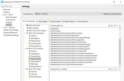

Here's what's included via the project settings:

Thanks @LCE for the reply.
I've checked those project locations and they are the same as mine.
I've even taken a cube project and then copied my files in, keeping LWIP files where they are, and then removed the cube files.
These are my include paths from my .ewp file:
