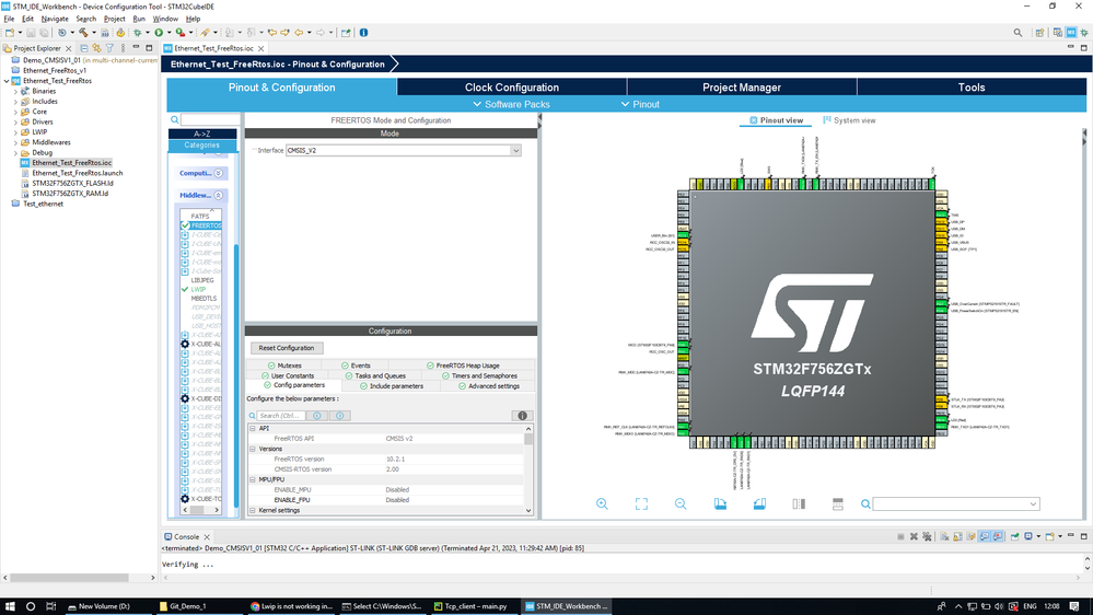

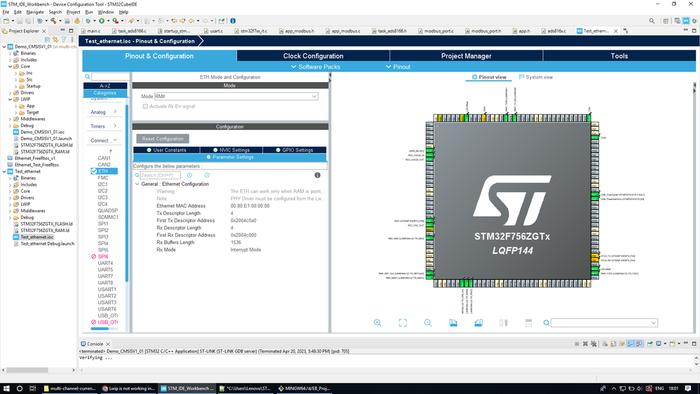

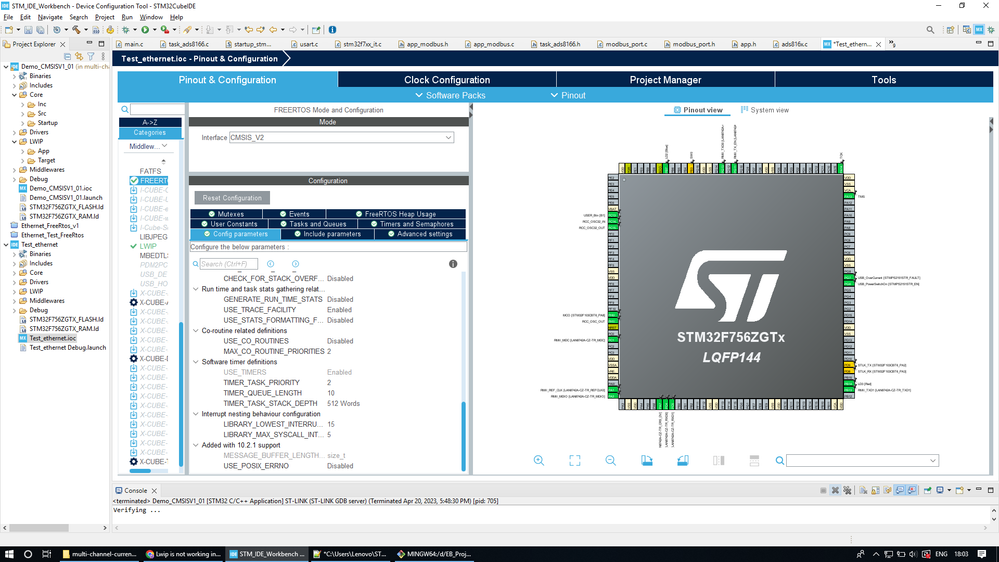

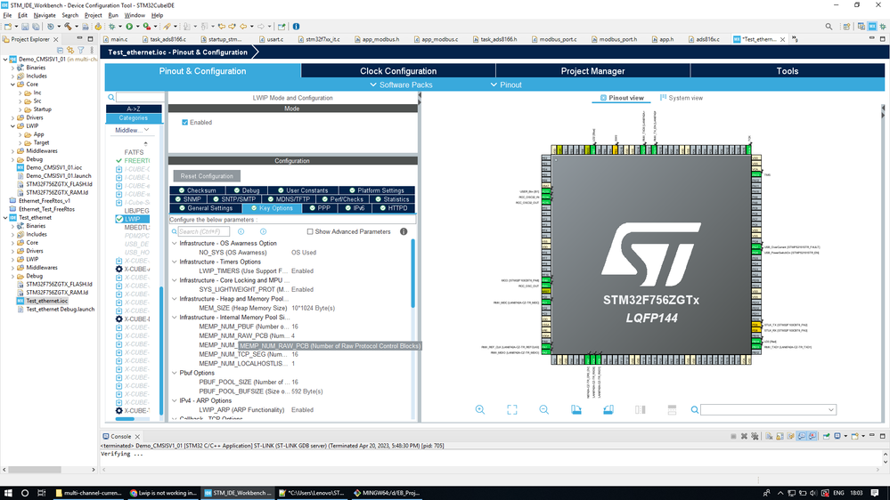

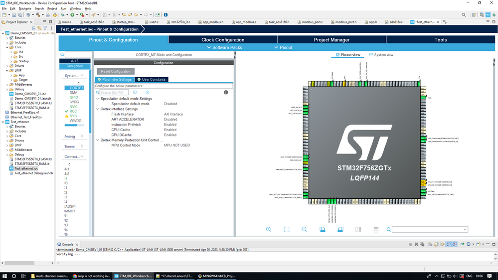

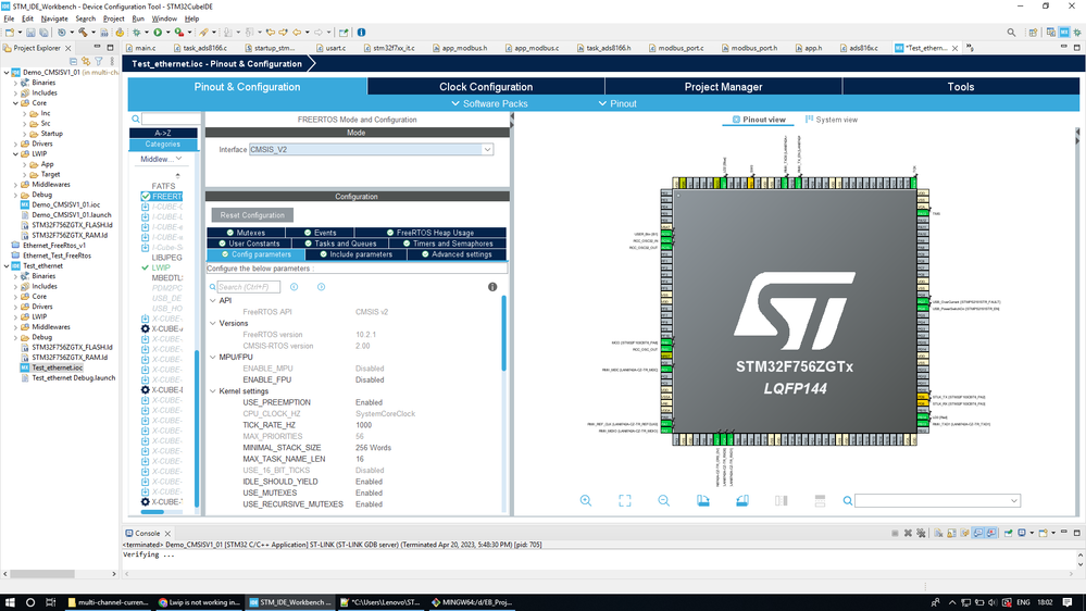

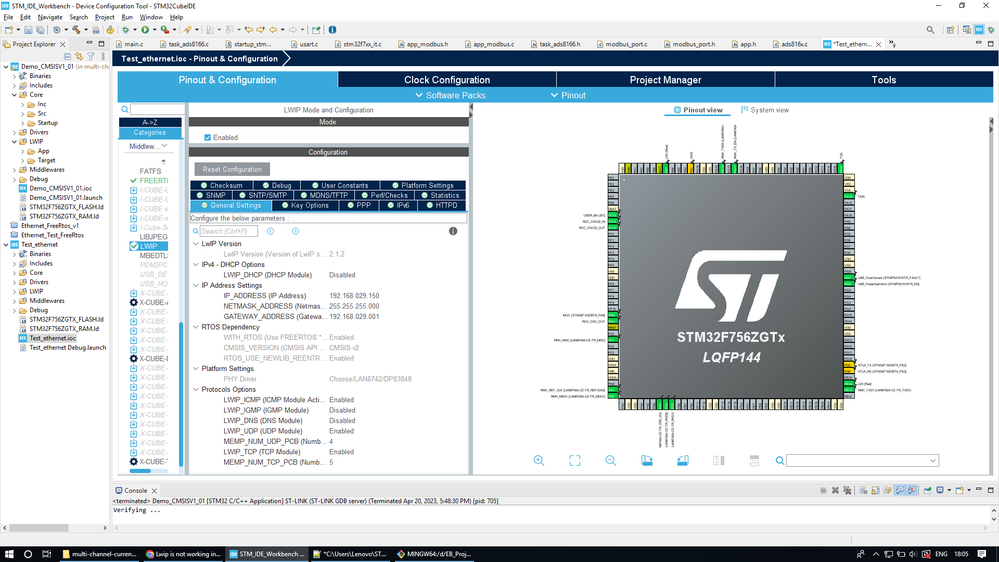

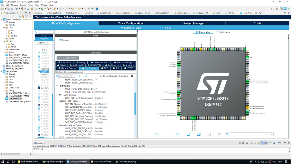

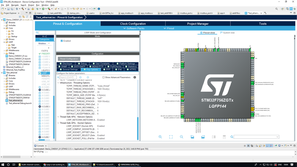

I am using STM32CUBEIDE 1.12.0.
Scenario: I want to create a TCP server with FREERTOS CMSISV2.

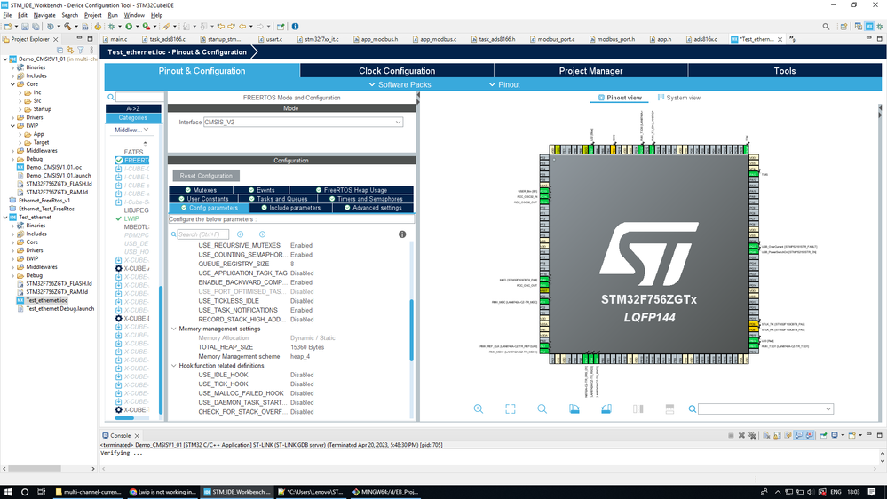

Steps that i follow,
Step 1: configure ethernet.
_legacyfs_online_stmicro_images_0693W00000biUtgQAE.pngStep 2: freertos configuration
_legacyfs_online_stmicro_images_0693W00000biUqEQAU.pngStep 3: LWIP configuration.
Step 4:coretex m7 configuration.

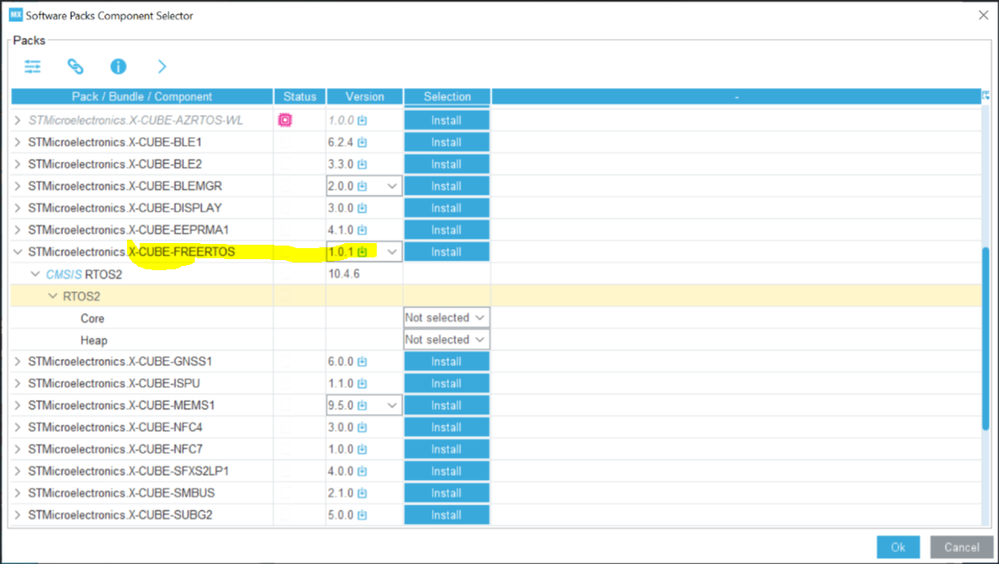

Please make sure to use latest version of STM32CubeMX v6.8 and x-cube-freertos v1.0.1, as it may be due to the known issue with previous version of x-cube-freertos pack which is already fixed on the latest version.

I would able to find a version of STM32CubeMX which is V6.8. But I would not able to find a version of x-cube-freertos. Can you please help me to find it?

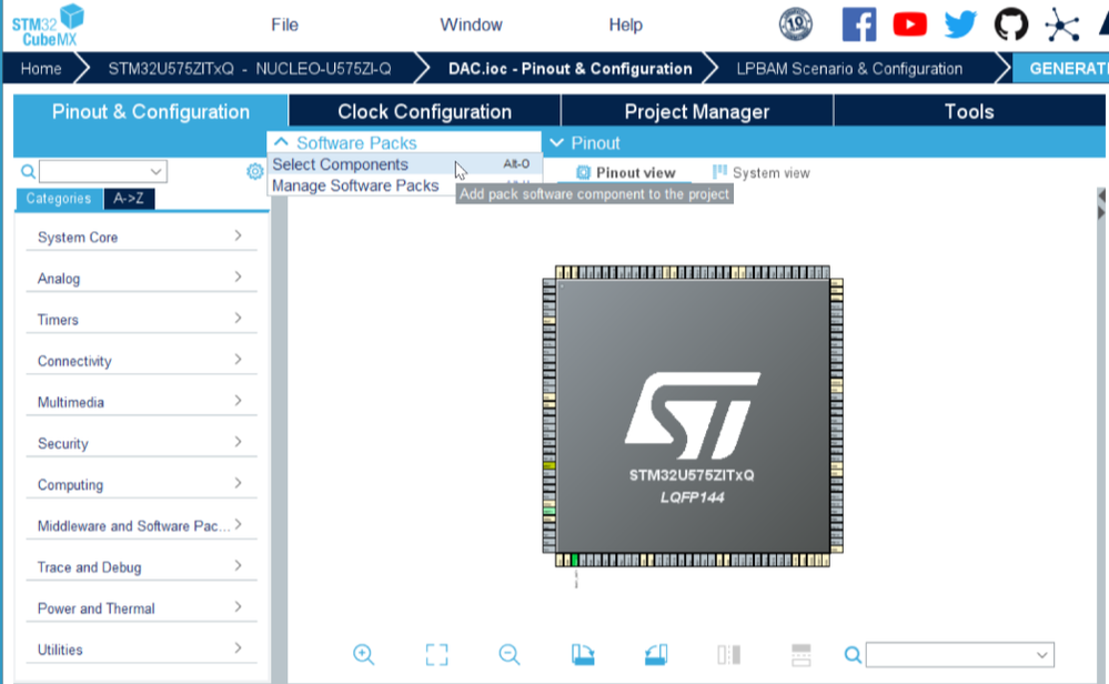

April 24, 2023
You can check the pack version in the "Software Packs"

I checked x-cube-freertos version which is v1.0.1.Although it is not working.

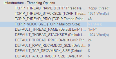

Had the same problem on stm32f767 trying to use LWIP with CMSISv2. I narrowed the problem down to erroneous data being written to the "TxPktSemaphore" Semaphores being used by the LWIP library. Turns out its because the assigned stack for the tasks are overflowing and writing into other areas of memory. All over the LWIP code the difference between the task size in words and in bytes is muddled. For example in the configurator I've chosen 1024 words as TCPIP_THREAD_STACKSIZE:
but in the code its actually 1024 bytes:
This seems to be a none issue for the tcpip thread, as they seem to have already set the default value to 1024 to account for it actually being bytes, but they seem to have forgotten to do this for INTERFACE_THREAD_STACK_SIZE in ethernetif.c. I manually added a * 4 shown below and it fixed the problems:
Hope this helps :)

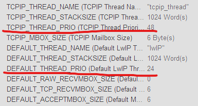

Visitor II
January 19, 2025
Oh and fyi for anyone with the same chip, you also want to:
- #undef LWIP_RAM_HEAP_POINTER in lwipopts.h
- Increase the stack size of the default task in the FREERTOS settings, I set mine 512 words, you might be able to get away with less by experimenting
- Change the thread priorities because the default values were valid for CMSIS v1. Heres what I chose:
- Probably also increase your FREERTOS heap size
