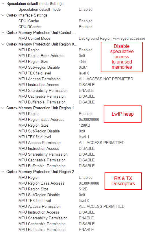

2024-02-12 03:50 AM - edited 2024-02-12 03:53 AM
You need to disable the cache for Rx and Tx ETH descriptors and LWIP heap using MPU. You have a data coherency issue:
So as said by @KDJEM.1 , refer to the link https://community.st.com/t5/stm32-mcus/how-to-create-project-for-stm32h7-with-ethernet-and-lwip-stack/ta-p/49308
Also please refer to the AN4839 "Level 1 cache on STM32F7 Series and STM32H7 Series" for cache usage and mistakes to avoid.
2024-02-12 10:41 PM - edited 2024-02-12 10:41 PM
Thank you all! After I configured the MPU, the LWIP heap address and modified the linker script, now working perfectly.
