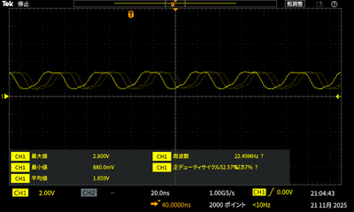

The PWM waveform output from PB0 shows the following problems:
  • The low level does not go down to 0 V
  • The high level does not reach 3.3 V
Before switching to PB0, I was using PA8 (TIM1_CH1), but I observed the same issue—
the voltage could not drop to 0 V.
I received advice that PA8 might be loaded by other on-board circuitry,
so I moved the PWM output to PB0 (TIM3_CH3).
However, the same reduced voltage swing occurs on PB0 as well.

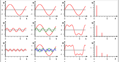

Because probe (and scope?) is 100MHz type, so looking at a 22MHz square, you can see 3. harmonic good, 5. harmonic is 22x5= 110 Mhz and will show still, but reduced level; and all higher harmonics your scope cannot show.
So all you can see from a perfect 22M square wave, is what you see now. (on 100M scope).
here 3. + 5. :

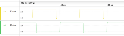

Pins are already in use, but it works fine here:
I suspect a measurement setup issue. Post pictures of your setup and show the scope plot of a significantly slowed down PWM, say 100 kHz.

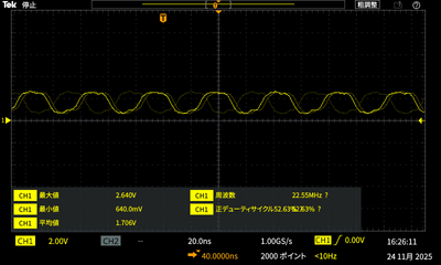

I used PF6 and I was able to output PWM.

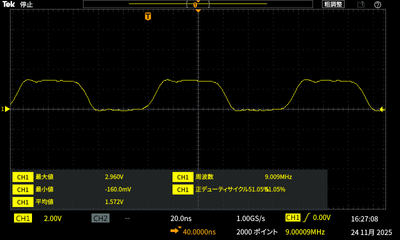

However, the voltage did not reach 0–3.3 V.
When I lowered the frequency, the waveform became close to 0–3.3 V, but I need a 20–24 MHz clock.
Fig.1 PF6 PWM 22.5MHz
Fig.2 PF6 PWM 9MHz
