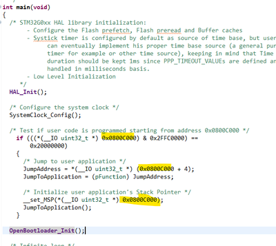

@j_filipe wrote:
@Saket_Om
So tried to do the function you showed me previously, I did it more or less like this, but it doesn't give the jump, it stays in while(1)...
Which while(1)?
While debugging, did the execution enter the if statement: if ((appStack >= RAM_START) && (appStack < RAM_END))?
Saket_Om
@Saket_Om
The while(1) inside main function...
No, the execution did not enter the if statement...

To do this, you need to modify the openbootloader code so that at startup it checks if a valid user application is present in the designated flash memory area. If an application is found, the bootloader jumps directly to it; otherwise, it stays in bootloader mode.
Here is how you can implement this:
1/add the following declarations:
typedef void (*pFunction)(void);
pFunction JumpToApplication;
uint32_t JumpAddress;
2/Define the application start address (for example, 0x0800C000), which corresponds to where your user firmware is flashed.
3/In the bootloader’s main() function, before entering the bootloader loop, add the following check:
/* Test if user code is programmed starting from address 0x0800C000 */
    if (((*(__IO uint32_t *) 0x0800C000) & 0x2FFC0000) ==
        0x20000000)
      /* Jump to user application */
      JumpAddress = *(__IO uint32_t *) (0x0800C000 + 4);
      JumpToApplication = (pFunction) JumpAddress;
      /* Initialize user application's Stack Pointer */
      __set_MSP(*(__IO uint32_t *) 0x0800C000);
      JumpToApplication();
This address (0x0800C000 ) corresponds to the start address of your application, which is defined in your application and must match the address used when generating the application.
After this modification of your OpenBootloader code, the OpenBootloader checks if there is a valid application present; if yes, it jumps to the application, otherwise it enters bootloader mode.
