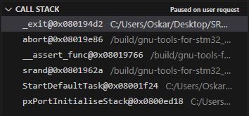

Whenever I call the srand() function, my code immediately ends up in the exit handler.
To troubleshoot, I created a minimal project with no additional middleware (bare minimum setup), and in that setup, the srand() function works without any issues.
However, in my main project where I need both lwIP and FreeRTOS, calling srand() causes an exit. The project was created following this guide:
How to Create a Project for STM32H7 with Ethernet and lwIP Stack.
I made one modification to the guide: instead of using the default OS wrapper, I selected CMSIS_V2.
Currently, I am only using the M7 core.
What I’ve Tried So Far
  • Minimal project without lwIP and FreeRTOS -> srand(12345) works fine.
  • Project with lwIP and FreeRTOS -> srand(12345) causes an exit.
I’ve attached an image showing the callstack where the issue occurs. I hope this helps in diagnosing the problem.

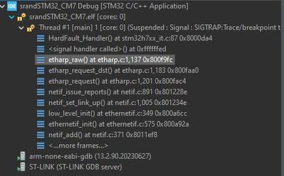

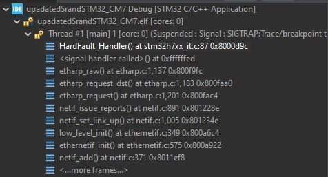

Hello SofLit,
Thank you for your quick response!
I call the srand() function in the main.c file of the CM7, specifically at line 362.
I tried building the project using Cube IDE with the same .ioc file. With this setup, the srand() function works, but I encounter a hard fault, as shown in the attached images.

__assert_func should (try to) write soemthing to stderr. You may catch the output by setting a breakpoint in your/default _write syscall implementation.
my guess:
NOTES
<<rand>> and <<srand>> are unsafe for multi-threaded applications.
<<rand_r>> is thread-safe and should be used instead.

Hello KnarfB,
Thank you for your suggestions. I believe lwIP uses the rand() function, so I need to call srand() to initialize the seed value. I will make sure to call it before starting FreeRTOS. That should resolve the issue with being thread unsafe at least for the srand() call.

Running your example with CubeIDE I got that hardfault but nothing related to srand() call. The hardfault is caused by  MX_SDMMC1_SD_Init() and may be the subsequent calls.
I commented out these lines and no more hardfalt occured again:
MX_SDMMC1_SD_Init();
MX_USB_OTG_HS_PCD_Init();
MX_FATFS_Init();
Sorry SofLit, that one's on me. However, even if I comment out the three mentioned function calls, I still hit the hard fault at the same location. Since this is a new topic for me, do you have any suggestions on how I can debug this further?

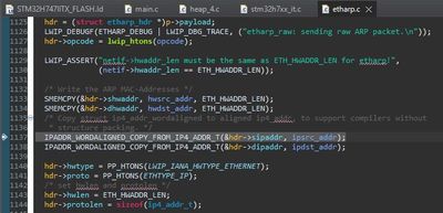

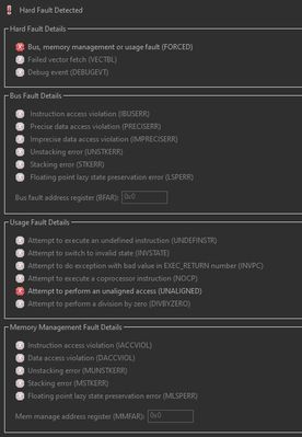

Yes I'm still in the CubeIDE.
I built the project with your attached .ioc file and commented out the following lines:
//MX_SDMMC1_SD_Init();
//MX_USB_OTG_HS_PCD_Init();
//MX_FATFS_Init();
However, I’m still encountering the same fault. The Fault Analyzer suggests an "Attempt to perform an unaligned access".
That's weird.. I cannot help you if I couldn't reproduce the behavior.. What CubeIDE version are you using. 1.17.0?
