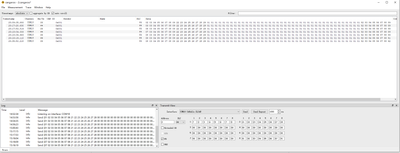

hello @Karl Yamashita @Ozone ,
this afternoon I get the CAN tool, now I am trying to extend CAN2.0 to CANFD with 64bytes payload, it is quite straightforward, just change the frame to FD frame and change rxbuffer size, txbuffer size, it seems i can send and receive 64bytes payload now.
Best Regards,
