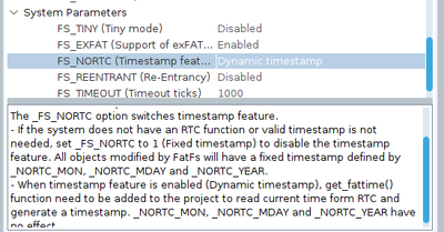

I got it reading and writing to the USB drive. At least with the small text sample from the code above. But that brings up another question - the sample code was able to create a text file named "Even.TXT" that contains the proper text "This is STM32 working with FatFs" but the file doesn't have a Date Modified value. There is no date or time associated with the file. How do I get a date and time for the file?
I dont know - you have RTC running, with actual date on your system ? (How it should know it otherwise ?)
see cube :

I got the timestamp to work. I had the proper settings in the IOC file but it still wasn't working. I looked around and found a variable in ffconf.h that needed to be set to 1. Line 220 =  #define _FS_NORTC 1. It was set to zero. Now I am getting the file created with the time stamp.
Actually it's not working correctly. Turns out setting FS_NORTC = 1 bypasses the RTC and uses values set in the ffconf.h file.
I need to figure out how to use the
get_fattime();
