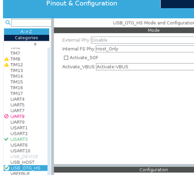

usb to host only

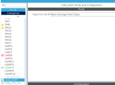

usb host to msc
+ here platform setting...

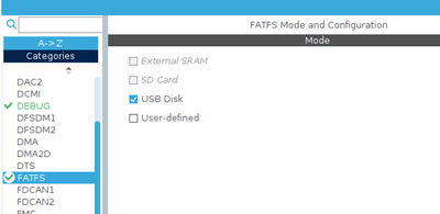

then fatfs to usb disk
if you want : long file names (i do..)
and exfat (for big > 32GB sticks)
ok...save file, generate code . (the gear symbol..)
