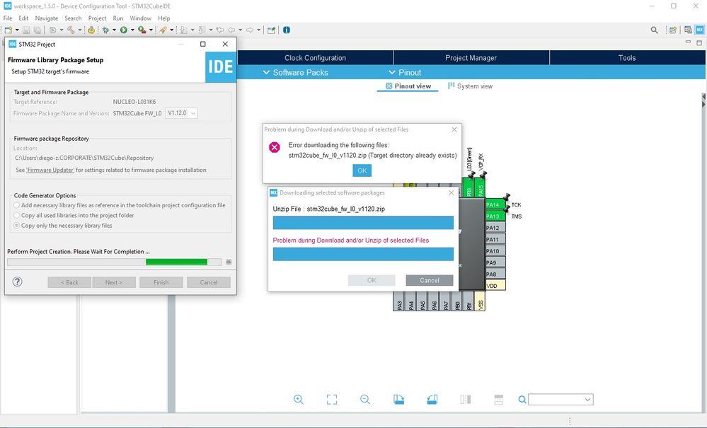

I installed STM32CubeIDE v1.5 and I created a new project based on STM32L0 microprocessor. After downloaded the L0 package, the installer fails. I noticed that in the STM32Cube_FW_L0_V1.11.3.zip the folder Utilities/PC_Software is missing (and therefore also the setup file...)

Hi Imen,
Thank you for your support. My question arises beacause if I try to create a new project based on L0 target in STM32CubeIDE 1.5, I get this error
0693W000005CPrEQAW.jpgHow can I fix it?

Do you use a proxy? You can check the proxy settings in CubeIDE : Window > Preference > Network Connections.
If you use a proxy, you have to fill in HTTP and HTTPS, otherwise without proxy (with Direct and Native), you don't have to fill in the fields, just keep all fields empty.

DZall.2
This morning I managed to complete the download, probably the problem was with my corporate network...
