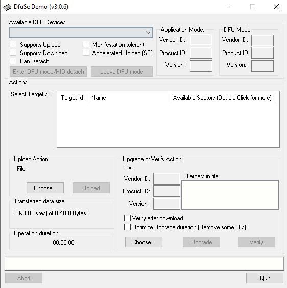

I would like to try the DFU on my Nucleo F413ZH. I have downloaded Cube F4 1.25.0, and opened the application "DFU_Standalone" in the "USB_Device" folder. I have also installed "DfuSe Demonstrator" and the drivers. In the peripheral manager, I can see the "STM32 Bootloader":
Unfortunately, the "DfuSe Demonstrator 3.0.6" doesn't detect the device:
I am working on Windows 10 64 bits and IAR 8.42.2.
Any idea on what I am missing ?
Thanks.

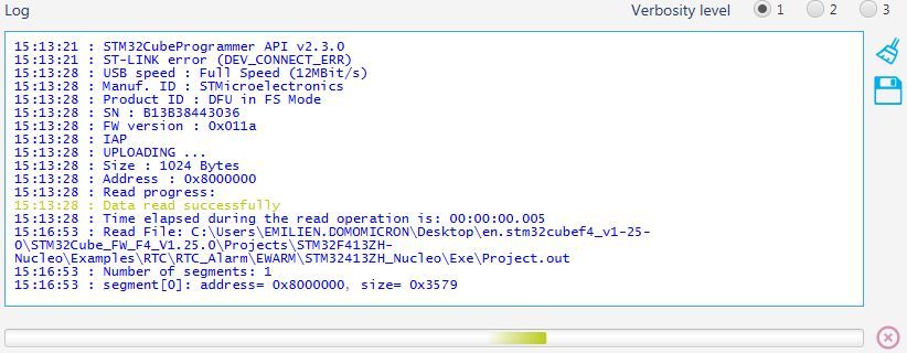

Thanks for your quick answer.

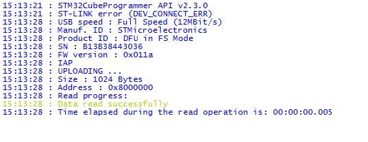

No, STM32CubeProgrammer is able to detect the DFU device:
0693W000004JSTtQAO.jpgBut unfortunately, when I try to updload a new hex file to the uC, nothing happens, CubeProgrammer is blocked at this step:
0693W000004JSY0QAO.jpgAny idea ?
