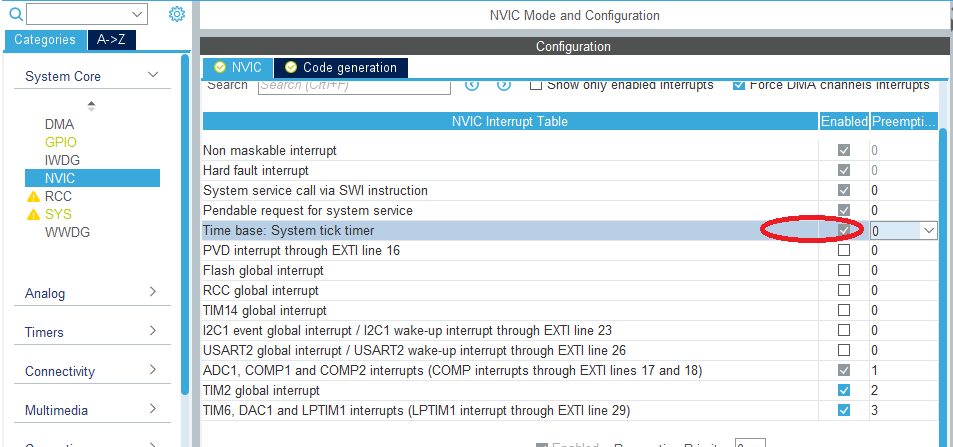

Is HAL_Delay() implemented with SysTick() interrupt ?
Is ​it safe to use HAL_Delay() in while loop main.c
with other ( low priorities ) interrupts?
​Thanks
Karan​

Yes. By default it uses a counter which is incremented by the SysTick interrupt handler once every millisecond.
Thanks for update..
Do I need to change ​(lower) SysTick priority if I have HAL_Delay() in while (1). ?
​Where other high priority interrupts? ​

The HAL_Delay() use the counter register of SysTick, but not the SyStick iterrupt.
The HAL_Delay() is an active polling loop waiting for SysTick interrupts.
This is why HAL_Delay() should not be used in an interrupt routine.

By Below Priorities setup , the code stuck in infinite loop and then hardfault
Should I avoid HAL_Delay and use dummy delay as below ?

As @berendi​ replied, in main just call HAL_Delay. Unless you need delay while interrupts are disabled. Or unless you want more precise delay (microseconds). Just try it. Do not change the systick priority.

But Why below type of delay can't produce constant delay every time ?
void __delay_ms(int32_t k)
	int32_t i,j ;
	for(i=0;i<k;i++)
		for(j=0;j<3000;j++)
Karan
Execution time depends on lots of factors, e.g. interrupt activity, code alignment in flash. It can never be relied upon. Use a timer or a counter derived from a timer, like HAL_Delay().
Ok ..Thanks .. But I also want to use high priority interrupt with HAL_Delay() and don't want to disable that like Pavel A. (Community Member) said ..

Do not use HAL_Delay() or any other kind of delay in interrupts.
