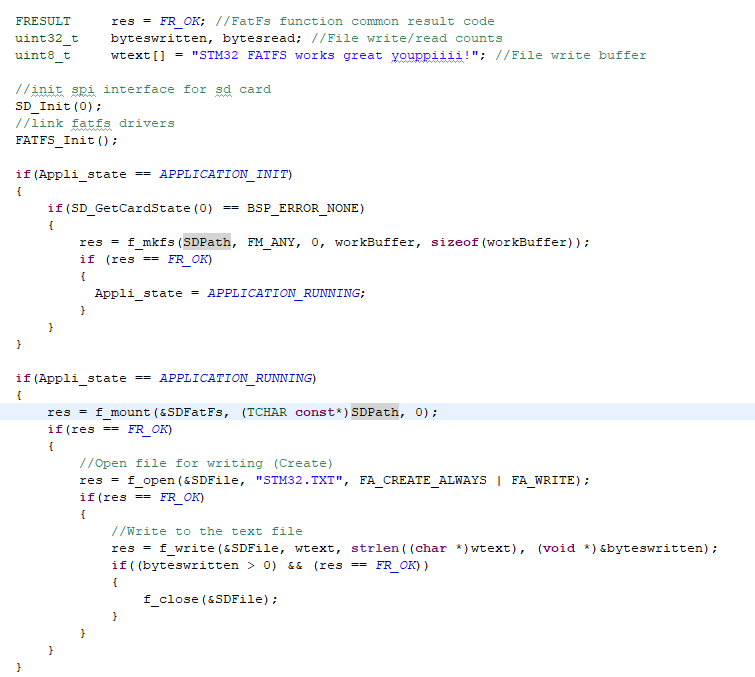

I build an application with FatFs Middleware to log data on a uSD card.
I used the same protocol on FatFs_uSD application with wl55 mcu.
f_mkfs and f_mount function return FR_OK.
but f_open return FR_NO_FILESYSTEM
i tried to change between SDHC and SDSC
i passed the SD module power supply from 3.3V to 5V
i changed min heap and stack sizes
i changed _MAX_SS in ffconh.h
... but always the same problem !
any suggestion please ?

Top level functionality is predicated by operation of lower level block retrieval by DISKIO layer. If that fails at its basic level the file system won't work.
C​heck what is read from the card in these failing conditions vs what was written.
F​or large cards use EXFAT.
Shouldn't need to use f_mkfs on working cards.

FR_NO_FILESYSTEM is returned from find_volume function.
‎2022-09-19 6:28 AM
check_fs function return 3
0:FAT, 1:exFAT, 2:Valid BS but not FAT, 3:Not a BS, 4:Disk error
‎2022-09-19 6:30 AM
Cards don't run at 5V.
Are connecting to a simple socket, or something with a regulator and level shifters?
T​he error suggests the data read does not meet expectations of an MBR or BPB structure on the media.
Sounds like you need to focus on the electrical interface, and basic block read and write functionality.

‎2022-09-19 6:59 AM
so : 5V at SDcard ?? all cards you "tried" are dead now.
- buy new cards.
- use 3V3 at SDcard
- leave away the f_mkfs (dangerous!!!)
- open root directory
- write file (fopen..)

‎2022-09-23 1:25 AM
I resolved the problem by modifying spi read ans write functions.
it is working now, but i still have a problem in fatfs application : i can not write two time on the same file !
