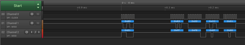

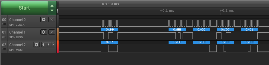

I am running a simple SPI transmit receive project with an STM32F411 (SPI Master) and STM32F303 (SPI Slave). Whenever I press the user push button on the STM32F4 Master, the Master will send a command byte (0xE1) through SPI and the STM32F3 Slave is expected to respond with 4 particular bytes. The snapshot of the logic analyzer below is what I expect to happen every single push button:

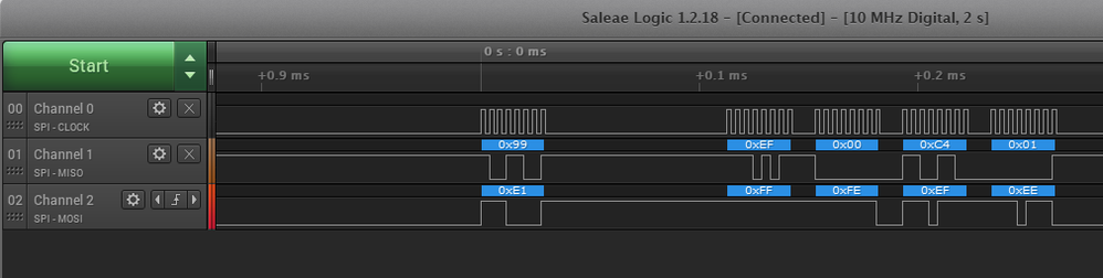

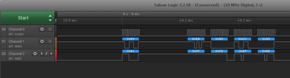

I could probably get the accurate SPI transaction above several times. However, most of the time, the snapshot below is what occurs:
After running through many tests, I am almost certain that the Slave is the issue because:

It looks like the CPHA setting on your logic analyzer doesn't match the CPHA setting on your device. The waveforms are the same.
4 replies
TDKBest answer
July 21, 2020
RrW1
RrW1Author
July 21, 2020
I don't know how I missed this. I was too focused on the code that I forgot to consider how the logic analyzer configuration might be incorrect itself. Thank you for the solution!
Both of the code's configuration was CPOL = 0 and CPHA = 1 (2nd edge), but the logic analyzer was configured to CPOL = 0 and CPHA = 0. I am reading the correct waveforms now.
I do have a question regarding the logic analyzer's readings though. Why is it that when the logic analyzer is configured to CPOL = 0 and CPHA = 0, the readings are always different? I would imagine that if the configuration is wrong, the waveforms produced would be wrong but it would show the same incorrect data all the time.
July 21, 2020
There is always some jitter in the signal. The logic analyzer significantly simplifies the waveform. Remember there’s a finite rise time and overshoot/undershoot. If your SCK was delayed relative to the data lines, the behavior would be consistent, but if you’re right on the threshold, results will vary. It also depends how the logic analyzer treats data in which SCK transition at the exact same time as MOSI.
