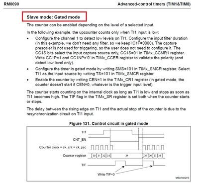

The most common frequency measurement is counting the number of pulses per unit of time. Moreover, STM32 timers have special modes for this. You can program automatic counting of pulses per unit of time. Another master timer can trigger another timer to count external (ETR) pulses within a specified time window. You simply read the value of the TIMx->CNT register. This is called gated mode in RM. And counting pulses from ETR pin.

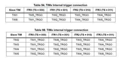

I'd spend a lot of time to figure out and use gated mode. It is a complex feature but this is worth to learn it and use.

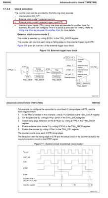

First you need understand what will be going when you meassure a signals. Simply you need a window time within you will counting how many pulses going on. So if you'll try to measure signals faster than 65KHz and if you window time will be 1sec, simply timer 1 is not enought  for this purpose bcos it have only 16bit wide.
So you can measure for example in 0.5sec window time and counted pulses multiply by 2. BUT it is not best way.

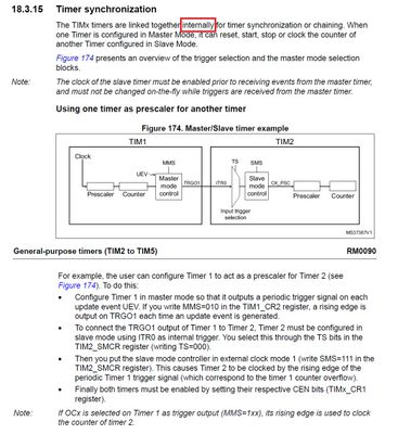

So you can also expand your timer1 up to 32bits and even more, bcos exists possibility to cascade connection many timers.
Simply in RM you can find text "using one timer as prescaler for another timer":
 Also you need check the internal triggers connections for timers:
So you can combine many function of timers for your purposes.

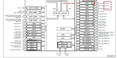

The next things is fact, you need for gated mode only timer which has an associated ETR input:
 Here is visible TIM1,2,3,4,8 have ETR input, but only the T2 are 32bit (!)
Now going simplicity - the easiest way to mesure frequency with wide range is using TIMER2, which have 32bit counter clock, what gave you easy use without manage and conection 2 16bit timers for make 32 bit value timer. OK but I recommended by the way is worth to try and understand how to connect timers as cascade. Just by the way for future.

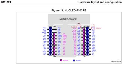

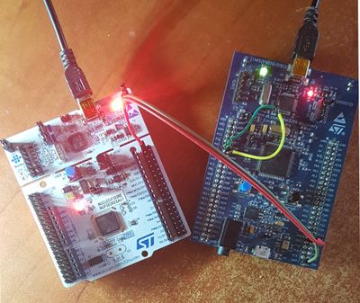

So I'm a bit familiar with freq meassurement and gated mode that's way I did the circuit and programs for check this...

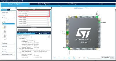

A generator I'd use and NUCLEO-F303RE where I used PWM 50% duty cycle with freq 1KHz and 1 MHz on the PC8 TIM3_CH3 generate 1MHz square wave, and PC9 TIM8_CH4 generate 1KHz wave.
 For meassure this I used DISCO F407VG. When you check , you get info about TIM2 ETR pin can be used in 3 places as alternated pins function (AF) on PA0, or PA5, or PA15. I used PA15.

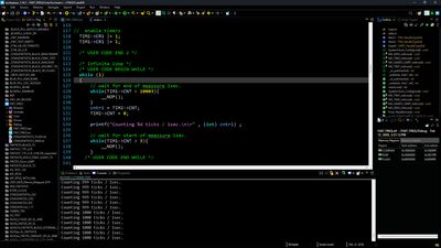

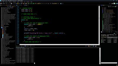

TIMER2 is in slave mode for TIMER1, I set only 3 variants:

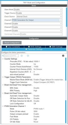

 TIMER1 is a master timer which gatting TIMER2. I'd set the time window (measure time) on the 1sec. and 0.1sec "dead" time in PWM "PWM_no_Output" this mean it work on the internals timers trigger connections without setting signal on the any externals pin. TIMER1 making on the internal trigger PWM 1.1 sec period with duty cycle 10/11. after dead time meassure going over again.
The settings of TIMER1:
 A working circuit looks like:
Measurement of 1KHz:
 Measurements are very stable. 1MHz measurement:
 Added in attachments programs for "NUCLEO-F303RE as square wave generator" (PWM.zip) and "DISCO F407 as Freq meter" (F407_FREQ.zip).
