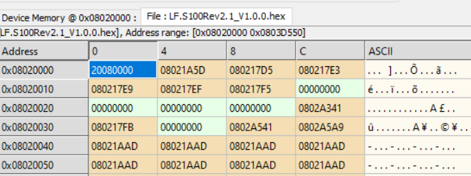

0693W000000VC2uQAG.pngOne more strange thing:
The value store in address 0x8020000 is 0x20080000 which mean if (((*(__IO uint32_t*)USER_FLASH_FIRST_PAGE_ADDRESS) & 0x2FFE0000 ) == 0x20000000) will return false condition. That 's why my bootloader can't jump to my app.
So you already know where the problem is. Why don't you solve it? Have you answered to yourself what that code does?
Sorry, my bad. I tried to change mask value from 0x2FFE0000 to 0x2FF00000 , so I can jump from bootloader to app. But I don't think it is correct way.
BTW, If I compile the code in Keil C, I have different first 4 bytes in flash (0x20008098) which is satisfy bootloader requirement (0x20008098 & 0x2FFE0000 =0x20000000). Isn't it weird?

You still haven't answered the following questions:
  1. What is that first word in vector table? The answer is in PM0253.
  2. What are you trying to do with that value in your if condition?
