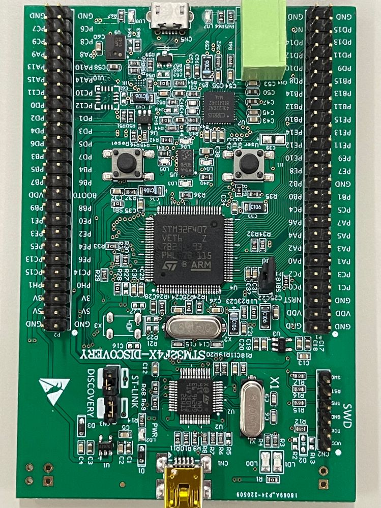

I am using a STM407VET6 development board, and when I connect it via USB, it is recognized as "STM32 ST-Link" as a USB device, but not as a VCP.
How can I solve this problem?

‎2022-08-02 10:56 PM
What board? Post photo.
JW​
‎2022-08-02 11:01 PM
I'm using​ this board.
‎2022-08-02 11:07 PM
This board has a ST-LINK/V2-A which does not include VCP. See
STM32F4DISCOVERY Data brief and
TN1235 Overview of the ST-LINK versions.
hth
KnarfB
‎2022-08-02 11:10 PM
Can add VCP by soldering 2 wires, see UM1472 Discovery kit with STM32F407VG MCU
