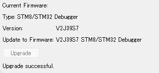

Have you upgrade the ST-LINK firmware uisng STM32CubeProgrammer or such? The tool should state the link type: Debug+MSC+VCP

Okay. Footnote on page 12 of UM1472 Rev 7 states that VCP does not apply to that board. They have probably changed the ST-LINK chip. You can add an external UART to USB adapter (FT232).

  • is not a genuine ST board, it's a clone
  • as the STLink is STM32F103C8T6, it cannot support the STLinkV2-A firmware which has the VCP (that would require STM32F103CBT6), only the older STLinkV2 firmware without VCP
