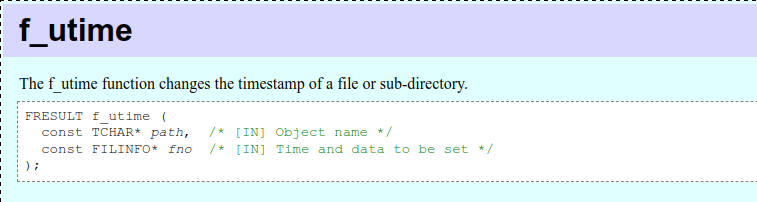

I do have RTC working and SD, I found this code
 FRESULT set_timestamp (char *obj)
   FILINFO fno;
   HAL_RTC_GetTime(&hrtc, &sTime, RTC_FORMAT_BIN);
      HAL_RTC_GetDate(&hrtc, &sDate, RTC_FORMAT_BIN);
   int hour = sTime.Hours;
   int min = sTime.Minutes;
   int sec = sTime.Seconds;
   int month = sDate.Month;
   int mday = sDate.Date;
   int year = sDate.Year;
   year+=2000;
   fno.fdate = (WORD)(((year - 1980) << 9) | month << 5 | mday);
   fno.ftime = (WORD)(hour <<11 | min <<5 | sec/2 );
  f_utime(obj, &fno);
but it keeps saying undefined symbol f_utime
I see that ff.c contain this function, I do not know what the problem is

AScha.3
in fatfs by chan... ->
http://elm-chan.org/fsw/ff/doc/utime.html
_legacyfs_online_stmicro_images_0693W00000bk6niQAA.png+++ set in cube: fatfs -> set defines !!! ->
Removed MPU tag, betting your not using those.
PLEASE always state the MODEL/FAMILY of MCU you're using in the TOP POST, it's not hard and conveys useful contextual information.
Check how you're building / configuring FatFS
Make sure you have clock info handled in DISKIO.C unpack a SysTick counter into human / calendar centric data, or use RTC, or whatever..
it is custom board STM32L4S9ZIT6, as I mentioned everything is working fine calendar, SD card is working fine. Created in CubeMX 6.8.0
I already found this link in Google, there is nothing to help me solve the problem.
