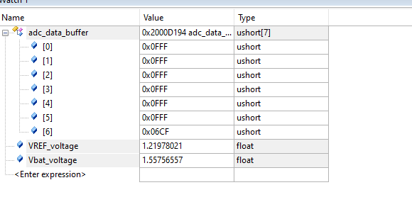

I'm having trouble in measuring the VBAT through ADC. I'm using 3.3V on aNUCLEO_476 board to connect to VBAT and when I measure VBAT through ADC,I cannot obtain the value of the VBAT
Here's my code:

waclawek.jan
What are the raw readings of VREFINT and VBAT, what is the *VREFINT_ADDR content, and what is the actual voltage measured at VDDA?
You may also read out and check/post content of ADC registers.
Hi JW
*VREFINT_ADDR value is 0x0681,
But there's a really weird thing: when I connect the VBAT pin on the NUECLEOL476 development board to the 3.3V on the board, all of the adc registers value is 0x0000,I don't konw why

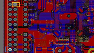

Isn't VBAT connected to some other circuitry on that board? (I haven't checked).

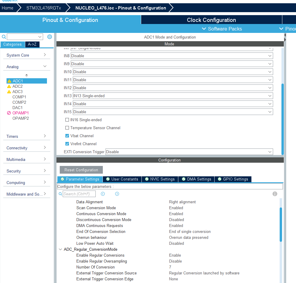

yeah,I connect VBAT with the Onboard 3.3V,and following is mine ADC config

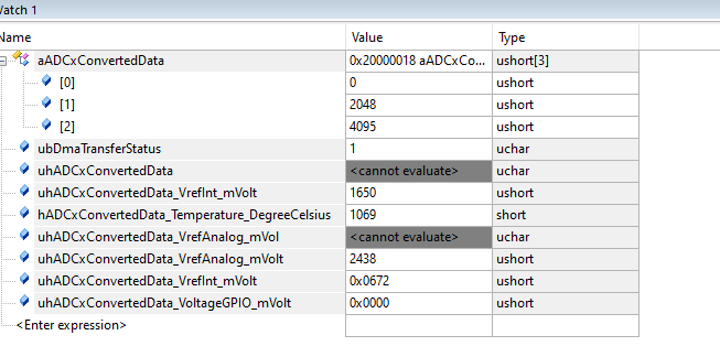

Thanks for your  suggestion,When I tried to use the program under Projects\NUCLEO-L496ZG\Examples\ADC\ADC_Sequencer, it got stuck in the HAL_Init() function. However, I carried out debugging using the program under Projects\NUCLEO-L476RG\Examples_LL\ADC\ADC_MultiChannelSingleConversion.
I have obtained the following data:
These data seem to have some issues.
I noticed that the VBAT and VDD on my board are connected together and I'm not sure if this affects the VBAT acquisition data.
