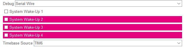

I understand the time base is a common issue often because of the interrupt priorities, but I think I have everything setup correctly. I am using Timer 6 as a tick source, with its IT priority set to 0.

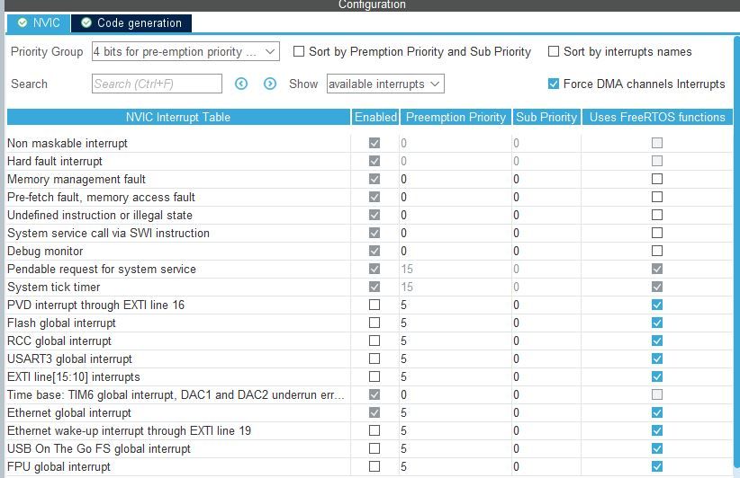

Could you please Try with ETH preemptive interrupt higher that other peripherals. Or just test the ping functionality with all other peripherals disabled.
Why set it to 0 ? (highest priority)
if FreeRTOS is used, the interrupts shouldn't be higher priority (so lower value) than FreeRTOS's configLIBRARY_MAX_SYSCALL_INTERRUPT_PRIORITY in FreeRTOSConfig.h:
/* The highest interrupt priority that can be used by any interrupt service
routine that makes calls to interrupt safe FreeRTOS API functions. DO NOT CALL
INTERRUPT SAFE FREERTOS API FUNCTIONS FROM ANY INTERRUPT THAT HAS A HIGHER
PRIORITY THAN THIS! (higher priorities are lower numeric values. */
#define configLIBRARY_MAX_SYSCALL_INTERRUPT_PRIORITY 5

I think you have it backwards.
configLIBRARY_MAX_SYSCALL_INTERRUPT_PRIORITY is the highest priority level that can be assigned to an ISR calling a FreeRTOS API. That's what the comment you copy/paste states.
What I described is the other way around: FreeRTOS is calling the HAL driver API functions which are using HAL_Delay which is NOT a FreeRTOS API, so it is fine.
Ironically, the code example you suggest in your second answer sets TIMER6 's ISR priority exactly to the same level, 0:
/*Configure the TIM6 IRQ priority */
HAL_NVIC_SetPriority(TIM6_DAC_IRQn, TickPriority ,0U);

Everything you are saying is done by setting "Timebase source" to TIM6, which is what I have done already.
stm32f7xx_hal_timebase_tim.c is generated automatically by CubeMX and is identical to the one in the example linked.
