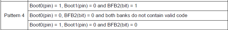

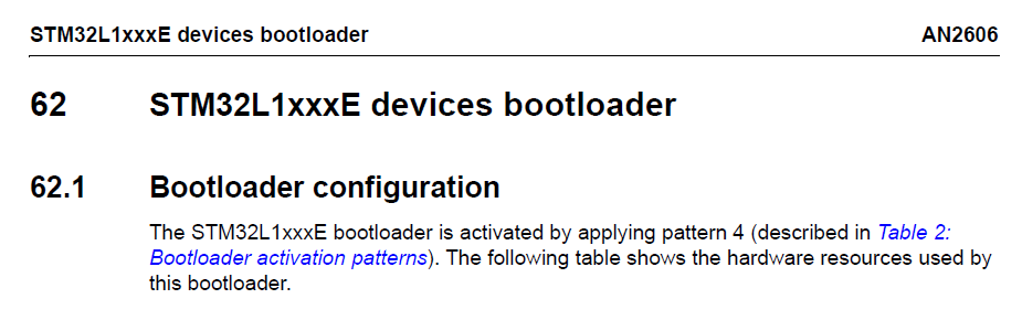

Currently, I am using the STM32L162VE custom board. I want to enter the USB DFU mode but am not able to enter the mode. This chip supports the USB and USART pre-programmed bootloaders. I have referred to the application notes AN2606 and AN3156. I did the below steps with reference to AN2606.0693W00000aIvUhQAK.png0693W00000aIvVBQA0.png

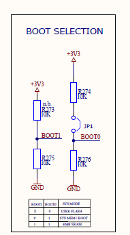

For making the BOOT0 pin to 1, have connected the JP1 jumper and Boot1 making as 0 as below.0693W00000aIvVLQA0.pngIs there any DFU standalone application for STM32L162VE/ ZE?

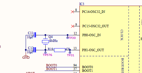

Hello @VNasa.1​ and welcome to the community :smiling_face_with_smiling_eyes:,
Maybe the problem here might be caused by the HSE crystal.
For that, I advise you to follow this FAQ: DFU mode with system bootloader is not working, while USB does.
Also, you can get inspired form the DFU_Standalone example available in STM32CubeL1 package.
This example may help you by following the instructions in the readme file.
Finally, I advise you to refer to AN3156, this application note describes the USB DFU protocol used in STM32 microcontroller bootloader, detailing each supported command.
I hope this help you!

I am using 8Mhz external oscillator on the board as below.
0693W00000aIzrkQAC.pngI have a few doubts as below.
