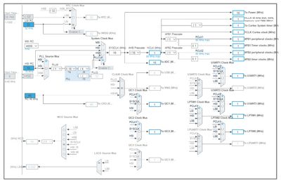

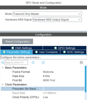

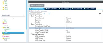

‎2024-08-13 6:13 AM
Thank you all for your helpful suggestions and insights! I appreciate the time and effort you’ve taken to assist me.
I’ve been referring to the RM0394 Reference Manual, particularly section 6.2 on Clocks (page 178), but I noticed it doesn’t specifically mention SPI. In my configuration, I’m unable to directly adjust the SPI clock. While I can reduce the clock frequencies for other peripherals like I2C, the SPI clock appears to be fixed and non-adjustable.
My primary goal is to reduce the CPU clock to the lowest possible value while ensuring the LCD screen operates within a suitable clock range. I attempted to lower the overall MCU clock to 1 MHz, but this significantly slowed down the screen refresh rate, making it less practical.
Here are my questions:
Is it possible to reduce the MCU clock and still keep the SPI clock high? If so, how can I achieve this configuration?
Can I use an external clock source specifically for the SPI peripheral while reducing the main MCU clock? Would this approach be effective in balancing low power consumption with acceptable display performance?
Considering my goal of minimal power consumption, what would be the best strategy to drive the LCD using the STM32L412? I plan to use an SMPS for VDD12, so any advice on optimizing power usage while maintaining screen performance would be valuable.
‎2024-08-13 8:20 AM - edited ‎2024-08-13 9:35 AM
1. I mean no SPI clock is based on PCLK2 then in transfer time PCLK must be 2x SPI speed. After transfer can swith down...
2. Too NO.
3. Use partial update method for screen and switch to low power after transfer changes.
By energy law is irelevant if you use low SPI speed with low current long time vs high speed short time. Avoid animation at all.
L4 is SPI 1.3.x hw
Specific handling of autonomous SPI operation in low power modes is out of this document scope. Version 2.x.x
is capable to drive serial bus clocking in stop mode while raising asynchronous interrupts to handle data
exchange. Version 3.x.x, additionally, can handle the data exchange between the peripheral and memory via
smart DMA if implemented in the product. This is done without need for system wake-up, due to temporal
domain's clock requests handled by the peripheral while the data transfers can be synchronized with other
peripherals by internal triggers. Refer to documents targeting LPBAM control, such as AN5645 "STM32U5 Series
power optimization using LPBAM" Guidelines for enhanced SPI communication on STM32 MCUs and MPUs - Application note
